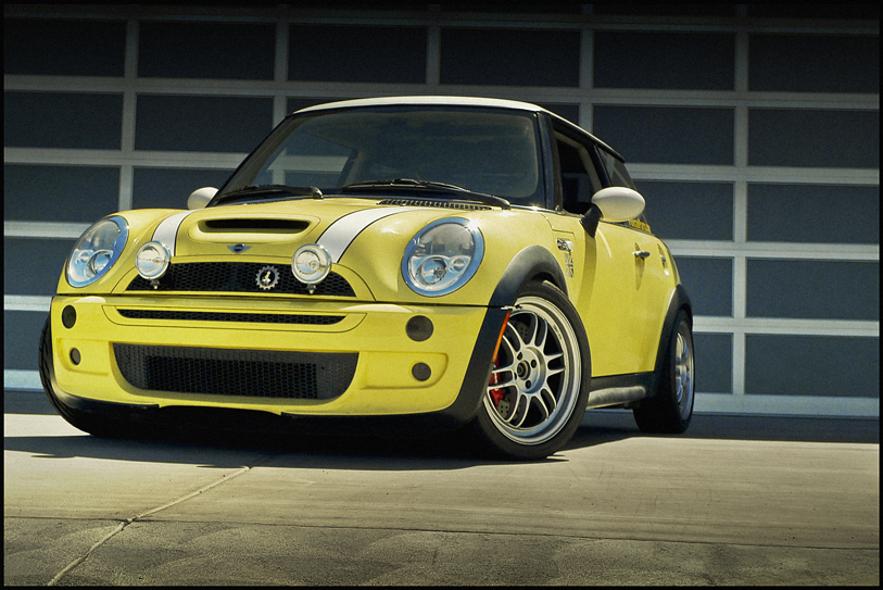

I run Enkei wheels as my race wheels because they aren't extremely expensive and they're light weight. We also run them on our in house MINI. Might need to double check and see if it'll work for yours though.
Just a blurb about Enkei:
"Enkei also produces sophisticated high-tech race wheels for a variety of motorsport, including rallying, drift, sportscar racing and single-seater racing – including supplying lightweight magnesium Formula 1 race wheels to Vodafone McLaren Mercedes."

They fit over the Brembo's on the yellow MINI, but not sure about yours. You may be able to give them a call and see if they know for a fact if they will on your platform MINI with the Brembo's.
