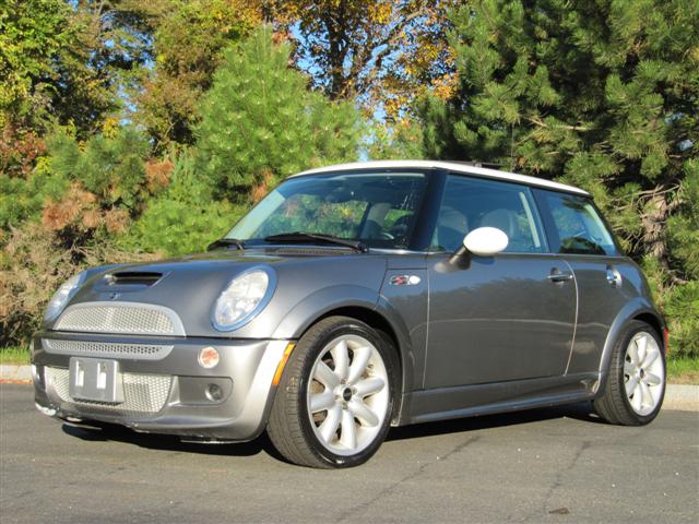

So I am looking at a 2002 S that supposedly has the JCW package. However i am not sure this wasn't just bits and pieces added afterward, and not the complete package.
How do I know the car has the proper motor, brakes and such. I couldnt see looking through threads here for the last hour or so.
In the engine bay, on the intake box, it has a JCW logo, nothing on the outside of the car, the front and rear bumper are all body color, with more aggressive looking spoilers, the suspension is harder and the brakes seem good. This is a dealer car so I can't get a history if stuff was added piecemeal or not at a later point.
