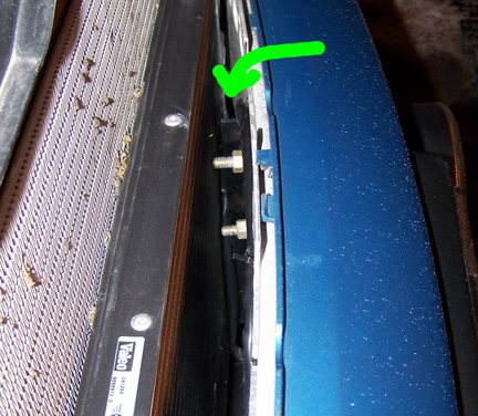

My dealer called me after having my car for 8 days to fix the AC... After the first two days they said they had it fixed, and I drove off only to have to bring it back. An inspection, diagnosis, and fix happened then. The same happened again and they said they had to replace the evaporator, and now out of nowhere they call and say 'your alta lightbar has pierced the AC condenser and it's going to cost $600 to fix'.
8 days with the car, constantly looking at and fixing in and around the AC system and this mysterious ailment pops up? They asked me if I wanted to 'see it first', and I said yes, but I won't be able to make it down until next week (unless I convince my boss to let me go early)... Arg.
Has anyone heard of this or seen this before? The way the lightbar mounts to the under-bumper brace, I would think there would have to be significant damage caused in order to bend that bracket back.

Had an epiphany. There are no lower bolts, they're all up high. So the bumper would have to be pushed in pretty far in order to push those bolts in, no? ARG, I want to go see it...

Yes, go look and take lots of photos. Nobody's borrowed your car or anyhting that could have run into something, right? That sounds really weird, but you can't rule it out until you see what they have to say. Was it a DIY install, or did someone do it for you? At least they're givingyou the chance to see what part peirced what. Good luck!
I did the install myself with a friend about a year ago. No issues.
I saw the car, and the bottom of the passenger bracket has been pushed in by someone or something, and the verticle bar has indeed pierced the condenser.

The lightbar definitely caused the damage, but thats because something pushed it in to do the damage. It was the medium, not the cause. It's like saying a baseball bat broke my windshield. The bat had to get moving somehow.

Wow, the light bar bracket would have to have moved almost 1 inch, to pierce the condenser.
So did you get into a fender-bender at any point in time? How could this have possibly be pushed into the condenser. Did you try putting on the bracket with the bumper on, (versus removing it first)?
Note to self... if ever installing that kit, saw down the screws after. They really DO stick back a good ways, don't they?

I'll try and take pics when I get home. The lights themselves were pushed in, but there is no evidence of damage to the lights. So the lights pushed on on the lowest part of the bracket, hard enough to pierce into the condensor. It's not the bolts, it's the 90 degree angle at the bottom of the L bracket.
Indeed. That damage was caused by a AAA towtruck sent by MiniUSA/MiniRoadside. I believe only the hood was damage because there was a bar that protected the cab from a rolling vehicle, but it's sort of possible. Only the passenger side bracket is pushed in, so I would rule out the towtruck because the damage would have been evenly distrubuted then.
I'd day it's more than possible. Unless you loaned your car to someone or drove so drunk lately that you'd not remember ramming something at about 15 MPH?
I'd be going after the tow company to make you whole- they're supposed to secure the vehicle before rolling out.
