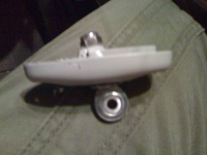

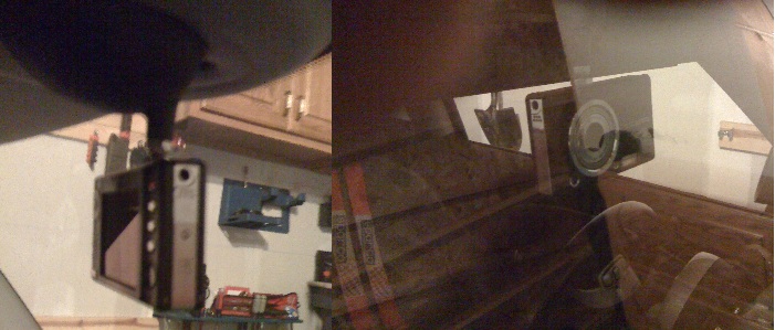

For anyone looking at a wink mirror...
I know they aren't real popular, but I do love mine. I've seen them done on minis maintaining the sun visors, but if you are willing to part with them, I came up with a pretty fool proof installation method. I had some spare pieces about from a set of splitter turnbuckles. I removed the visors from their mounts and put an eyelet through that hole, capped with a washer and locking nut. Because the eyelets move I did have to use a bit of extra pieces to hold them tight, but it maintains a pretty OE look, and it mounted in front of the OEM mirror, so worst case you could snap it pack on for inspections. I, however, in a fit of 3:00am creativity, turned mine into a camera mount...
