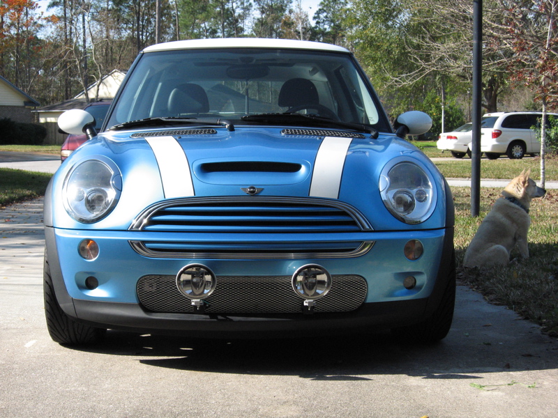

This weekend, I finished up with installing some Hella FF200 fog lights on Out Motoring brackets. The install went quite well and the only problem I encountered was my own fault when I did not level one of the mounts on the metal bumper. I didn't know this until I had already installed the lights and noticed one of them was 1 inch closer to the center of the car than the other. Instead of making the one vertical (and have to cut another inch of grill), I only moved it 1/2 inch towards vertical and then moved the other one 1/2 inch off vertical so they were both off by the same amount. This let me get by with only cutting 1/2 inch of grill more for each mount which is not very noticeable. It also gives me more room through the grill to get at the light connector without removing the brackets or grill. I tapped the stock fog light lead so whenever I flick the toggle switch to turn the factory fogs on, the Hella's turn on as well.
All in all, I'm very happy with it. The difference between the stock fogs and these are amazing. After driving around for a while with them on, after turning them off, the Xenons looked a bit dim . I plan on replacing the bulbs with yellow one's sometime this year. Here is the link to the install.
