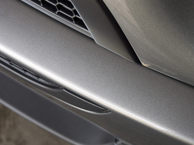

a photo
Here's a photo to show the "flush" mounting of the lower grille. Compared to others I've seen it's set back into the bumper a lot more. It's a subtle thing, though.
cheers,
