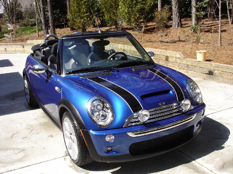

New 05 MCSC with dealer installed driving lights.
Switch under dash only activates on/off with high beams.
Can't switch be programmed to activate driving lights without high beams?
MA said no, then I drove off....
I want to turn them on and off whenever.
