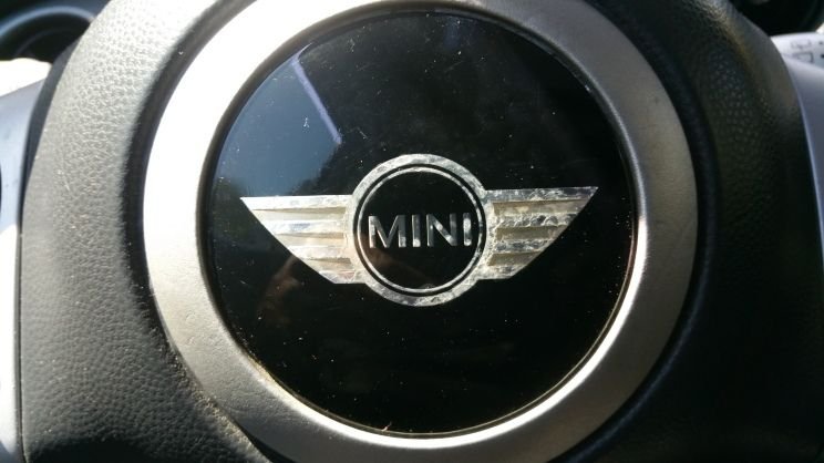

Having successfully extracted a near perfect center steering wheel/airbag emblem from a salvage yard Mini (as seen in my previous post ) - Here is what I started off doing.
#1_turn the emblem cap upside-down...
#2_Using a Dremel with a cut-off wheel; Sheer/ cutoff the 8 little barbs. You'll want to do this from the back side as not to chip the paint on the face of the emblem.
Then gently de-burr any remaining sharp edges with a drum sander attachment...
#3_ Beautiful. Now you have a nice button...
Pictured here is my original fading center cap still mounted on the steering wheel/airbag cover of my Mini...
#4_Now just pop that perfectly new/used cap right over your existing old one. No need to remove your old tired looking one -
The cap simply pops right on with no discernible protrusion what so ever.
The cap, by itself, fits perfectly snug but I recommend affixing it in place with a couple of small pieces of sheer clear double sided tape.
3M 4910 3M 4910
is what I had on hand an worked very nicely.
