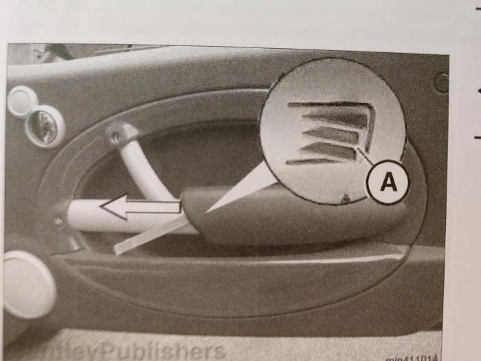

I've only removed a pair from a 2008 junkyard car that I intended to swap mine with but haven't changed out yet. Many times when I go to the junkyard I like to practice such stuff as trim removal and had a hard time with a stubborn armrest on one car and ended up breaking off a vital tab, so just be cautiously gentle because as usual with our cars the plastic can be super brittle --- the shorter -2004 versions may be easier to release though.
Sayeth H aynes:
Sayeth B entley:

Thanks for the photos!
Mine is an '03, so pre facelift shorter armrests. I don't have the big clip pictured and it definitely will not slide forward. There almost appears to be a ridge-like structure on the back side of the entire arms rest at the bottom. It feels like there are 3 or 4 indents in it for maybe screws from the back side of the arm rest handle into the actual arm rest? Can't get a look back there though becuse there is literally no space. Might try taking a couple pictures with my phone to see what that reveals.

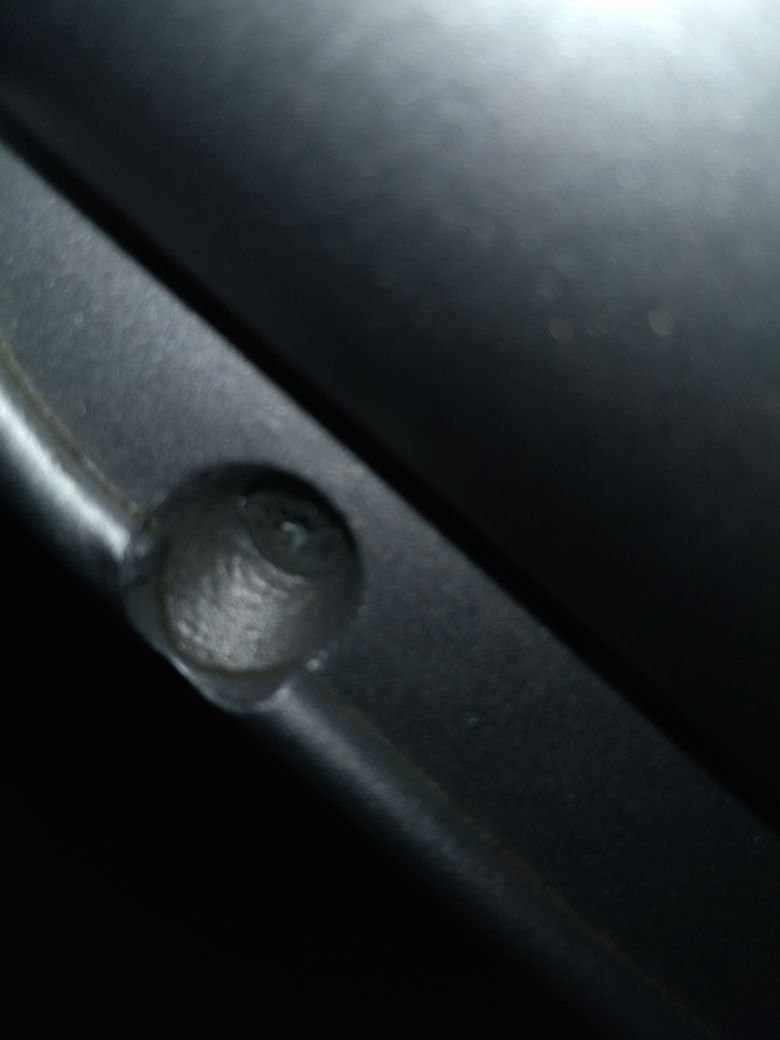

Yep... did manage to fish my phone in there and get a photo of the reclusive animal. Torx screws at the bare of the arm rest. At least 3 of them. How the hell...

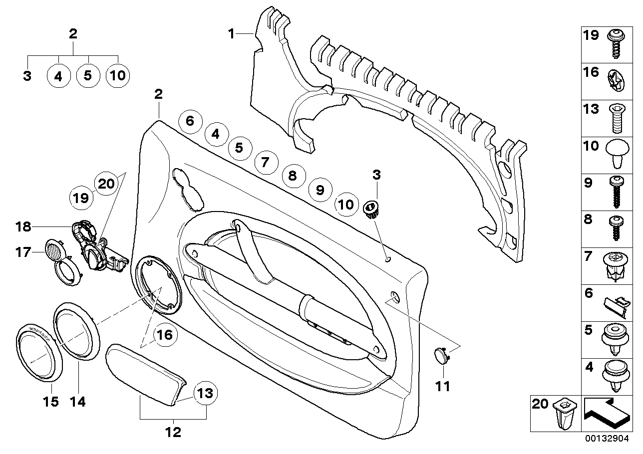

The pre-FL does indeed look different:
Surprised that info is so scarce regarding it, tried to look but couldn't find much.

Ah!
I actually think that's a better design than the FL which are prone to rattles, the screws seem like much more solid.
Tight spot to work with though!
