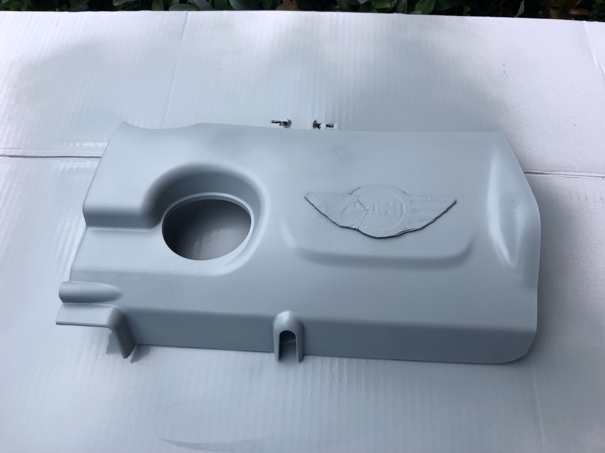

6. Use scuff pad to create a slightly hazy surface for the primer to bond
7. Apply primer following directions on the label, I applied 4 coats

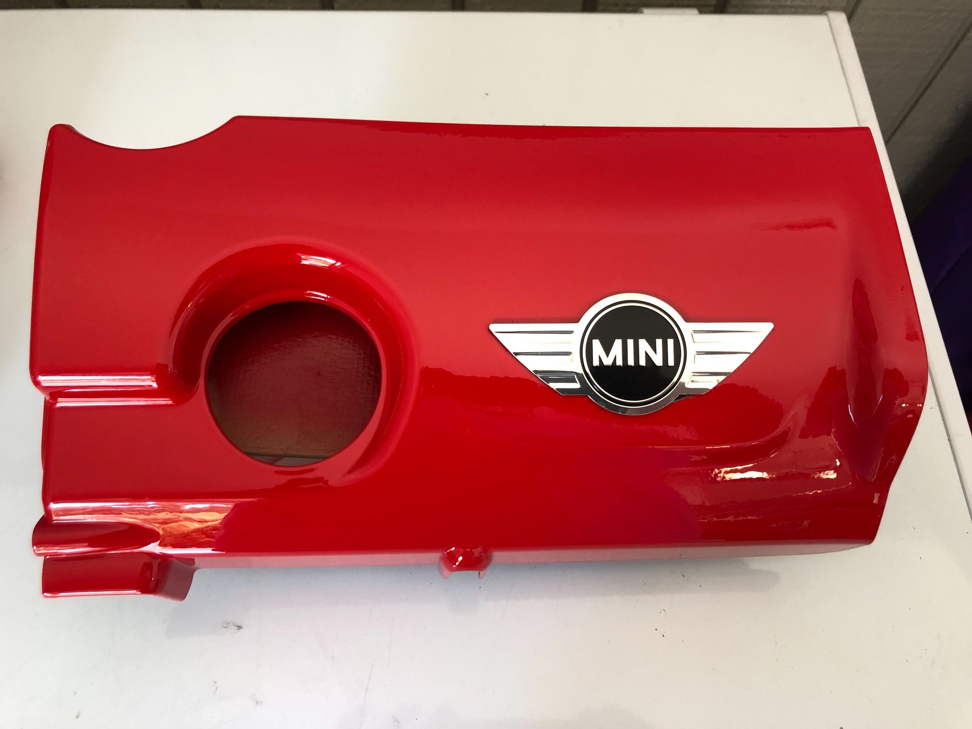

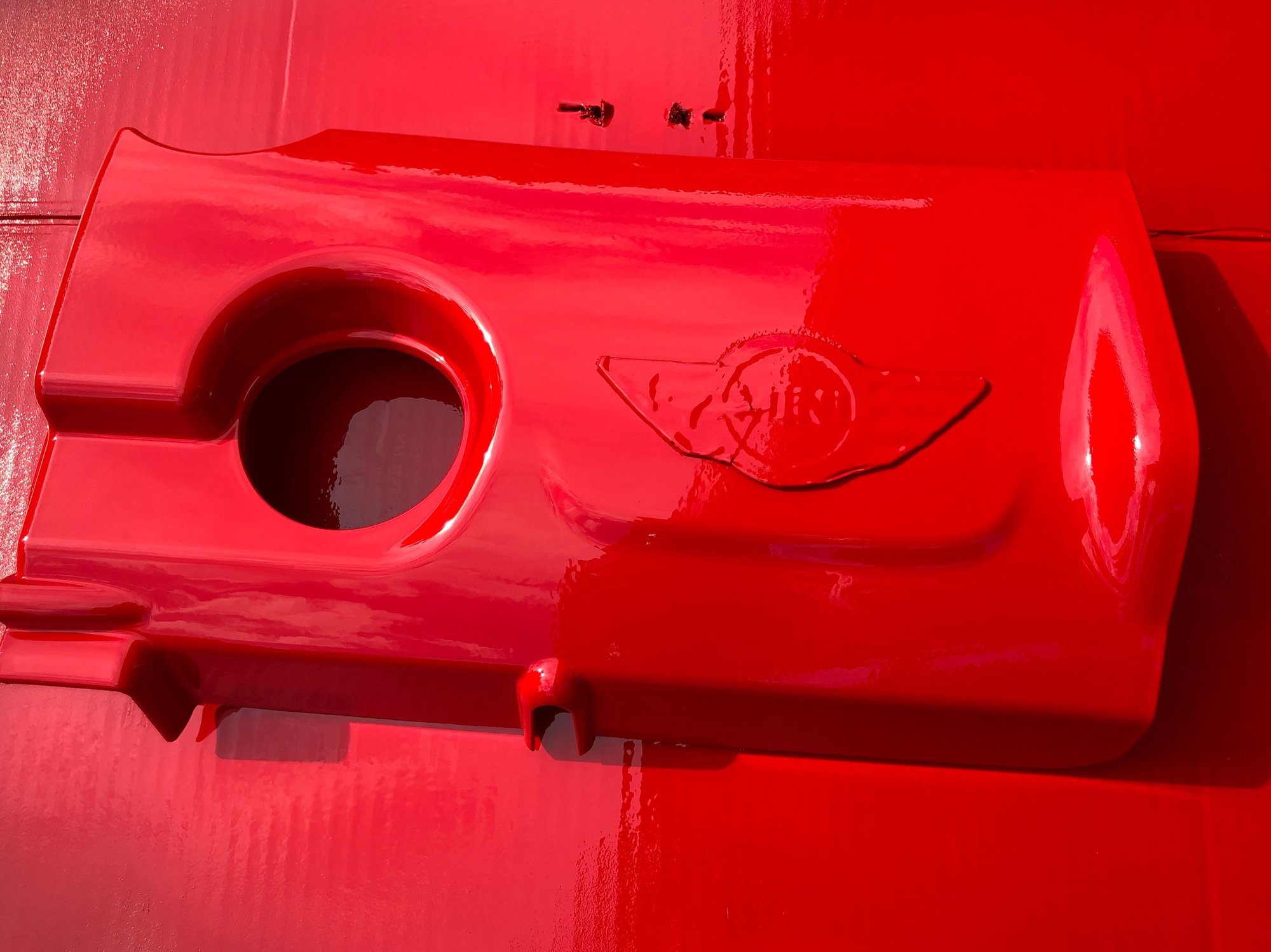

8. Apply paint following directions on the label, I applied 6 coats
9. Allow to dry
10. After dry time, use the edge of the razor to CAREFULLY pick off the tape, a second pair of hands work great!
11. Follow paint can instructions to allow time to dry before reinstalling
NOTE: This is my first attempt at painting something and was amazed at how well it turned out. I fully expected the need to wet sand to get a smooth finish.

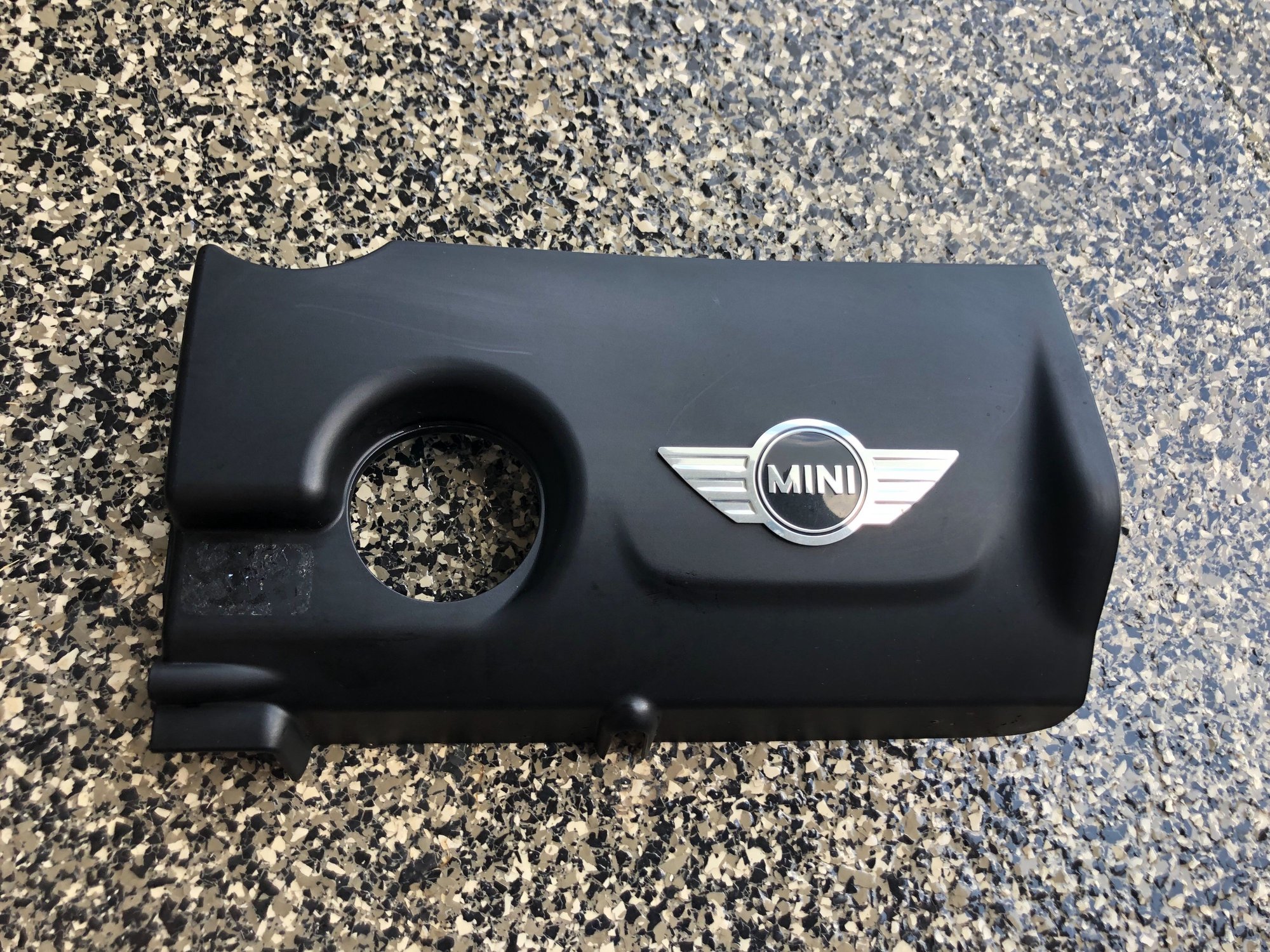

Before

After several coats of primer
After a couple of coats of paint
Last spray
Final look after drying
Final product and supplies used
