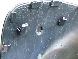

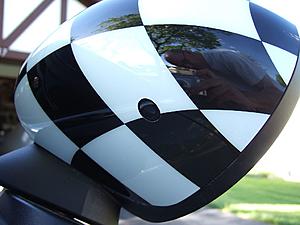

The big question with our F54's is how do we accommodate the logo projector under the driver's mirror. Turns out, quite easily (see pics below). Turns out the checkered pattern is some form of applique or sleeve placed over a stock mirror cap, which has the cutout in it. All you need to do is cut out the applique over the hole and voila!! I took a Dremel bit and plunged through the applique and then hand trimmed it out with an Exacto knife. Took me maybe 5 minutes to complete, then just snap it in place. So far the mirror caps have been quite a conversation piece, since they actually stand out more than I expected. Very happy with the minor mod.

- First pic is the inside of the driver's OEM mirror cap showing the projector hole.
- Second pic is the inside of the driver's checkered mirror cap...same hole in the base housing.
- Third pic shows the outer applique cut out from the inside.
- Fourth pic shows the outer applique cut out from the outside.

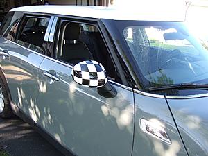

- Fifth pic shows the driver's mirror cap installed with the cutout.
- Sixth pic shows the new caps installed.
- Seventh pic shows the passenger side closer.
