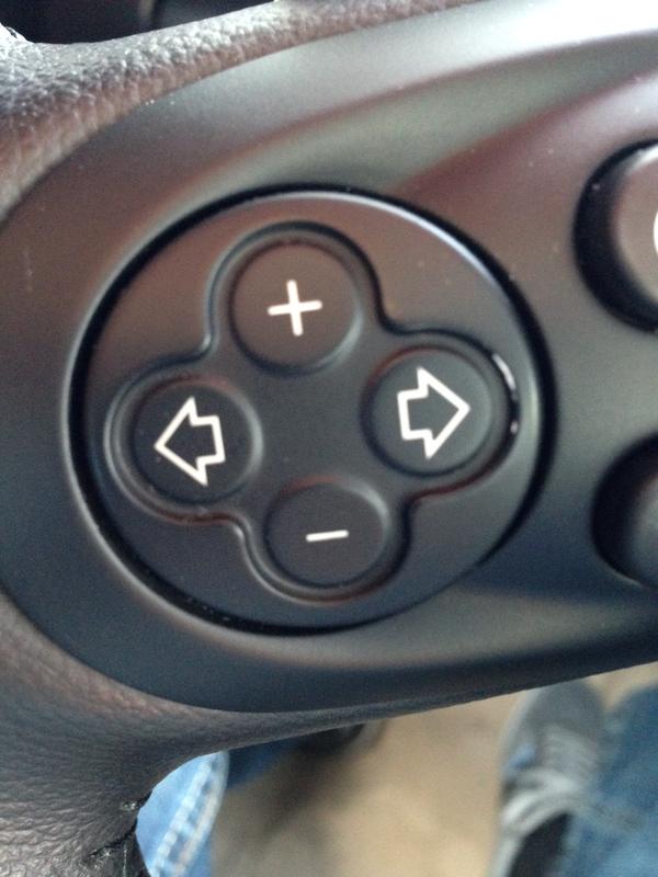

Hi
After 2 years "next" button begins to whiten as seen on the picture.
Any help?
Is it possible to get out the button and paint it full black?

If it bothers you that much.. You are better off just simply replacing the switch pack. They come off the wheel easily.
Unhook battery,
Press release pin on airbag.
Remove airbag.
Remove wheel.
Remove switches./ install new ones.

I used this paint (because I had some in my garage) to touch up where mine was showing white and it is a very, very close match.
http://www.amazon.com/Krylon-8831-Black-Paint-Primer/dp/B005LDBDIE http://www.amazon.com/Krylon-8831-Black-Paint-Primer/dp/B005LDBDIE
