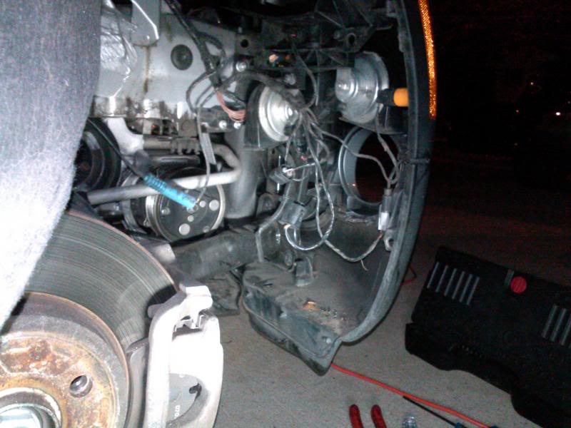

[SIZE=3][FONT=Times New Roman]To get to the fog light housing, remove fender liner. I think it was 4 or 5 of those plastic screw clip things...and then 1 bolt at 12-o clock position in the wheel well. To remove the fog light housing, there’s 3 bolts…two on the bottom and one on the top. [/FONT][/SIZE]
[SIZE=3][FONT=Times New Roman] [/FONT][/SIZE]
[SIZE=3][FONT=Times New Roman]Passenger side was easy because there's nothing between the liner and the fog light except for a couple wires.[/FONT][/SIZE]

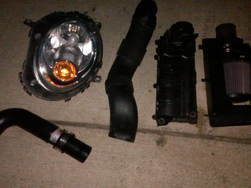

[SIZE=3][FONT=Times New Roman]Driver side was a little more complicated because the windshield washer fluid container was there and it completely blocked access to all three bolts. To free up room to get behind it, I had to remove the entire intake assembly as well as the headlight. Headlight wasn't necessary to remove, but it would've made removing and reinstalling that top screw of the fog light bracket hell. Plus it was only 4 bolts and it slid right out. [/FONT][/SIZE]

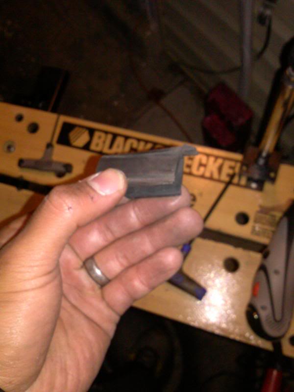

[SIZE=3][FONT=Times New Roman]Ok so this is the piece of the stock fog light housing that I was able to re-use. Once you remove the foglight itself you’re left with this. Notice that sloped underside. [/FONT][/SIZE]
[/FONT][/SIZE]
[FONT=Times New Roman][SIZE=3] [/SIZE][/FONT]
[SIZE=3][FONT=Times New Roman]Dremeling a 90 degree angle into that shelf made the PERFECT space to mount the D2 bracket flush against that shelf. Finally, drilled a hole through the top for the mounting bolt to pass through and voila…it’s ready to mount to the car. The D2 was ‘upside down’ when mounted this way, but the faceplate had 6 small screws that you could remove so I could flip it around to appear right side up. [/FONT][/SIZE]

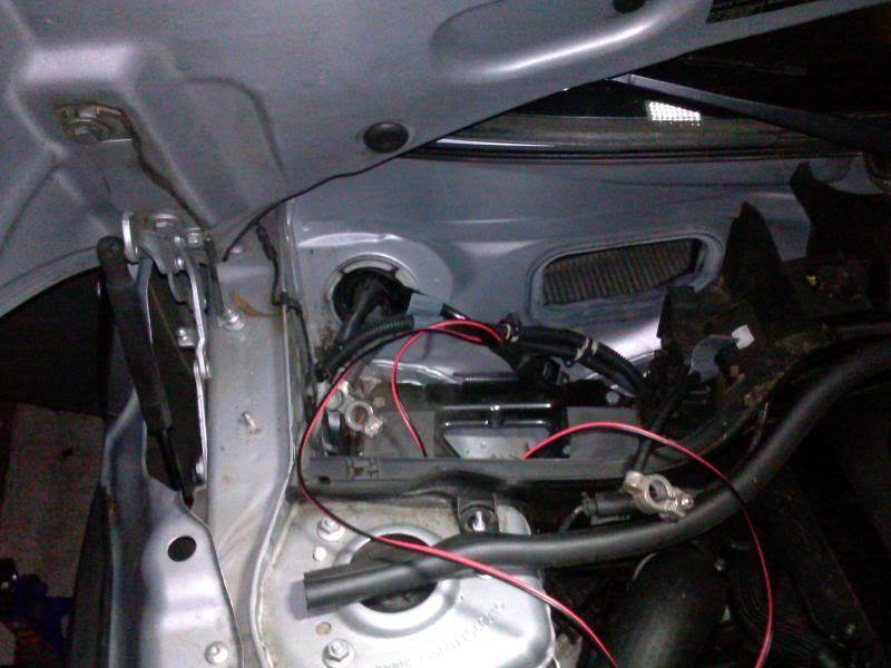

[SIZE=3][FONT=Times New Roman]After the lights were all buttoned up, I used the firewall gateway behind the battery to pass the control wires through. The plastic piece that sits over the battery was held in place by 2 plastic nut thingys…and 1 bolt. When you remove those, just lift up on the plastic piece and pull up. It popped right out…although I did have to finagle it under and around the windshield wiper. *This did not work on the driver side…you’d have to remove the windshield wipers first. [/FONT][/SIZE]

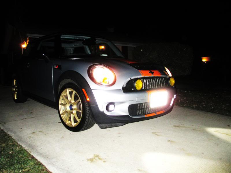

[SIZE=3][FONT=Times New Roman]Here it is mounted and on:[/FONT][/SIZE]

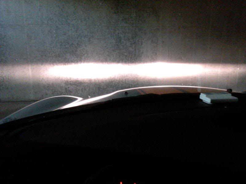

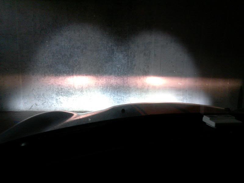

Beam pattern:
Low Beam only (halogen):
D2s only:
Low Beam and d2s:
Opinion after driving on the street
1) Simply put…better than any HID I’ve ever had. It’s a whiter, more intense light with a better, more even spread…I particularly like the spread to the sides…useful for helping to avoid deer. I’ve only had these mounted on atvs and dirt bikes and wasn’t too sure how’d these would light up the street. On a wooden trail, when it’s pitch black, it’s like the sun never went down when you have these lights…but that’s not hard to do when it’s pitch black, even cheaper PIAAs (not that PIAA is cheap, but their cheaper lights) were effective.…but on the street I wasn’t sure if ambient lighting would drown d2s out and render them as regular fog lights that barely lit anything up. Boy was I wrong. Actually, it was this guy’s video that ultimately made me pull the trigger. Here, he shows the difference between his 6000k HIDs…and the D2s.
2) Even when mounted as low as the fog light housing and pointed down…the beam spread is still intense enough to **** off oncoming traffic. I was flashed a couple times.
3) These lights completely drown out my low beam halogens…I could drive without them and be completely fine.
4) These were pretty expensive at $350 for the pair…but it’s well worth it. Also they’re indestructible…check out the rigid industries tests if you’re curious just how indestructible they are.
