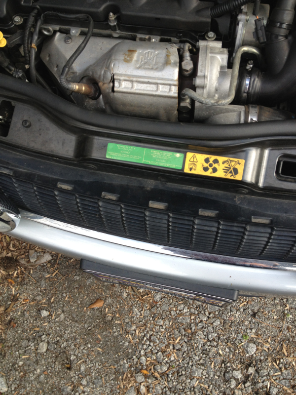

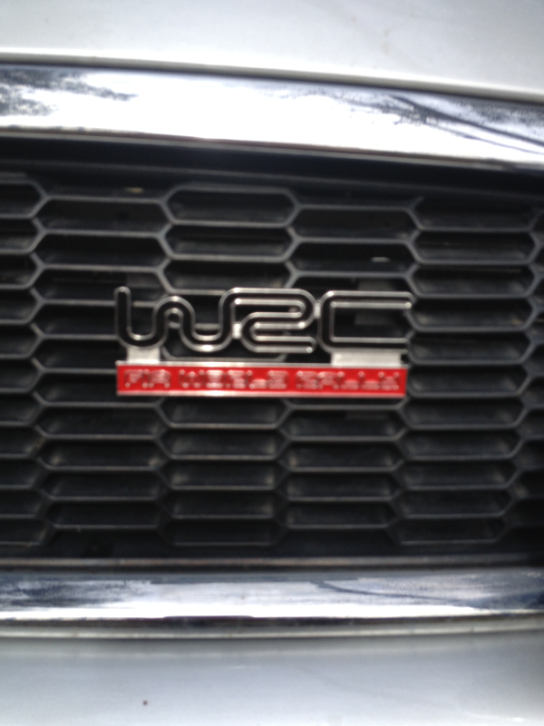

Hello everyone I want to install a metal emblem on the front grill of my r56 the problem is there's no room for me to get my hand in there so I guess I need to take it off so I was wondering how to do this the best way any advice would help

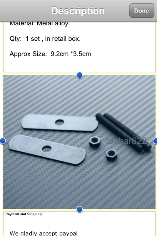

What does the fixture on back of the emblem/badge look like?

Pull the 4 push clips out. Then pull on the grill. There are tabs on the bottom that clip into the bumper. Make sure you press them in the correct direction. It should come off without much trouble

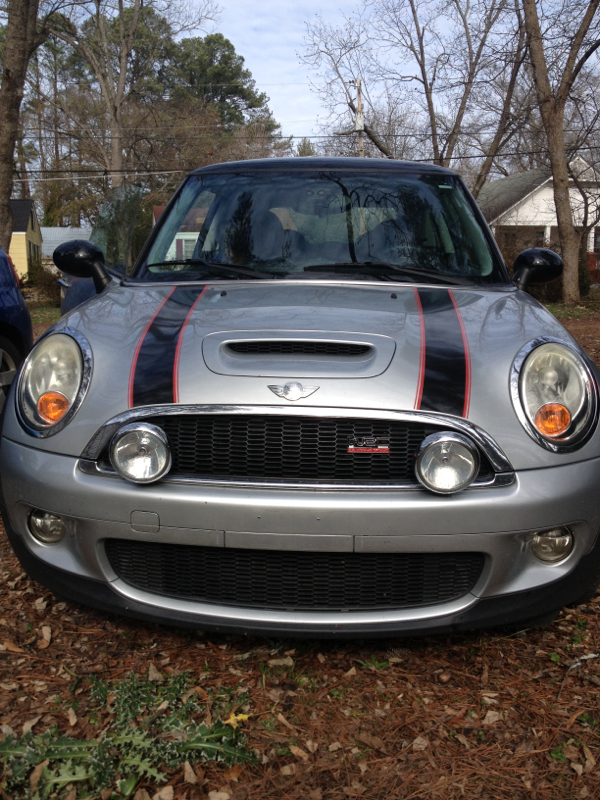

Thanks for the help everyone.. I ran into some trouble with the driving lights but I got it on here it is
