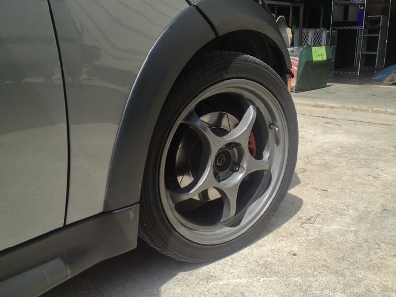

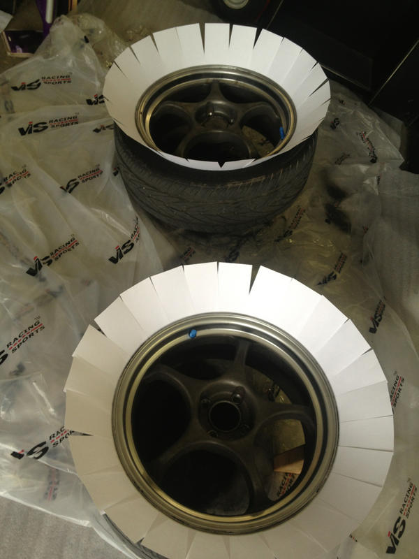

I painted my wheels this past weekend. Cleaned them up, covered them in three coats of plastic dip, then covered them in three coats of wheel paint from advance auto parts! Came out perfect! Almost an exact color match to my car too!
Attached Thumbnails Plasti-Dip Rim Short Write Up/Review!-image-296628906.jpg   Plasti-Dip Rim Short Write Up/Review!-image-2656269329.jpg   Plasti-Dip Rim Short Write Up/Review!-image-1906781187.jpg   Plasti-Dip Rim Short Write Up/Review!-image-2174440371.jpg

Nice job - the wheels look really good!

Thanks! Sorry to hear your wheels were so hard to clean! I'd look at advance auto and see if they have a clear coat wheel paint. I washed my wheels yesterday after I painted them this past weekend and it went from a somewhat rough surface to an almost smooth shinny surface. No chips or peels anywhere

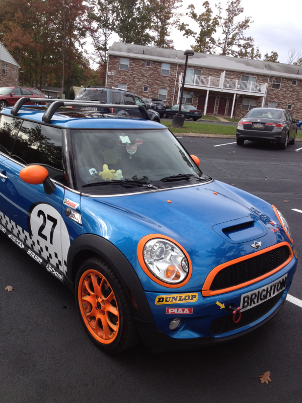

I dip my wheels to orange and I putted few layer of glossifier on it!
I use degreaser and sometimes meguiner wheel cleaner to clean the rims. So far the dip still stick to the wheel!
But one important thing is you gotta be careful with tireshine! As it will ruin the dip if you spray on it time over time. I would recommend using sponge or brush to apply tire shine!
Plasti-Dip Rim Short Write Up/Review!-image-3251462236.jpg

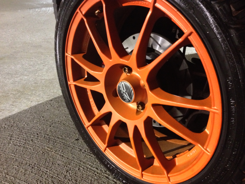

True! And it is very easy to apply!
Plasti-Dip Rim Short Write Up/Review!-image-2038266113.jpg

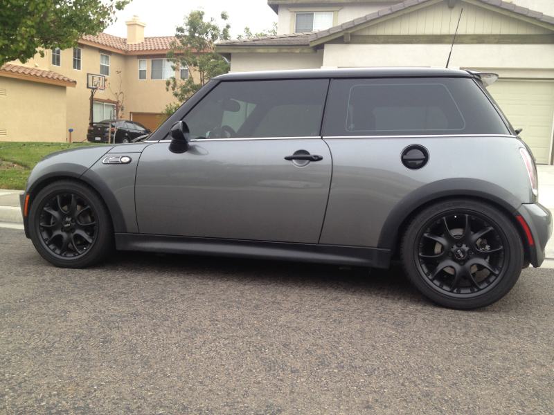

Plasti dipped my rims yesterday real easy just need to do some touch ups on them
Plasti-Dip Rim Short Write Up/Review!-image-2998369377.jpg

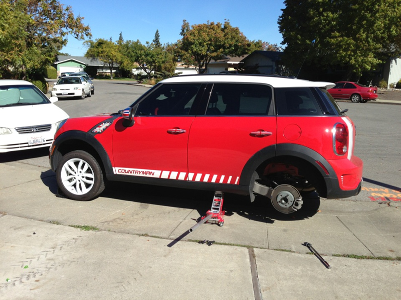

I did mine about a month ago. One wheel at a time.
Attached Thumbnails Plasti-Dip Rim Short Write Up/Review!-image-3109355206.jpg   Plasti-Dip Rim Short Write Up/Review!-image-2601967172.jpg   Plasti-Dip Rim Short Write Up/Review!-image-1617775947.jpg

Nice job on the wheels everyone! I think rac427's orange wheels look awesome on his car along with the decals and orange accents it looks so cool!
Flamewinger, your car looks much better to me with white wheels it just ties everything up. My wheels look just as good today as the day I painted them, I was using Sonax Full Effect to clean them but I ran out of it so I tried some Formula 88 degreaser I had and believe it or not it works better than the Sonax on plastidipped wheels. I have a small electric pressure washer and I just spray Formula 88, let it sit for a minute and then rinse with the pressure washer, no scrubbing! They look like new. It is also much, much cheaper than Sonax, like $3.50 a GALLON! Sonax is $99... So people, if you have a pressure washer just get some Formula 88 and your plastidipped wheels will look like new with no scrubbing at all!

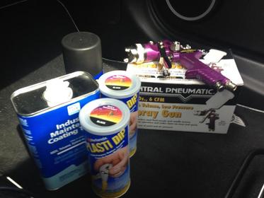

I've done my wheels twice and I recently removed the dip. I made this video of myself removing the dip. I had 6 coats.. Thicker the better and easier to remove.. I used a spray gun from harbor freight, air compressor, industrial thinner and dip in jar form not rattle can.
Here's a few photos and the video
Plasti-Dip Rim Short Write Up/Review!-image-461762309.jpg
Plasti-Dip Rim Short Write Up/Review!-image-3567744395.jpg
Plasti-Dip Rim Short Write Up/Review!-image-3903627025.jpg

Love the video and thank you for sharing. I am going to spray mine as well. I have a question though.
How are you guys painting the bolt holes? Do you paint the rim off of the vehicle or while they are on? How do you get it in there evenly if you are painting on the vehicle?

Painted off the vehicle is best
