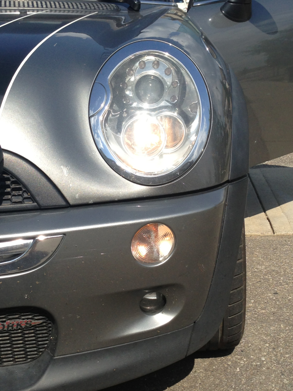

Question.....what bulbs are used for the turn signals? I want that xenon look for them aswell. Having the entire front match looks great!!!!!

I'm assuming you talking about matching the "park light" not the actual t/s.
To do this you must first replace the T/S bulb itself, the park light illuminates yellowish because of reflection off the amber T/S bulb, I can't remember off hand the # (eu or us) but you need to replace it with one of the silver reflected bulbs, they look silver/chrome but illuminate yellow for the T/S.
Then if it's still not what you want you will need to replace the park bulb (194 is the us #) with either an white led replacement or xenon blue tinted incandecent bulb.

I tried to attach a pic but got some error. I mean the lights under the headlights I haven't taken out anything so I just assumed there was a single amber bulb in the housing. I asked at Canadian tire for a replacement bulb that was clear or would match my xenon and they looked at me like I was insane. I figured if just need to order something off the net somewhere. After those are changed its onto the xze for hibeam and fogs unless I get the ones from eBay you installed.

Yes that's where I was refering to, there's actually 2 seperate bulbs there.

Well look at that it did attach the pic. Can I get those bulbs at any local parts store usually?

Should be able to, start with the T/S, just pull one & ask for the "silver reflective bulb that lights up yellow".
