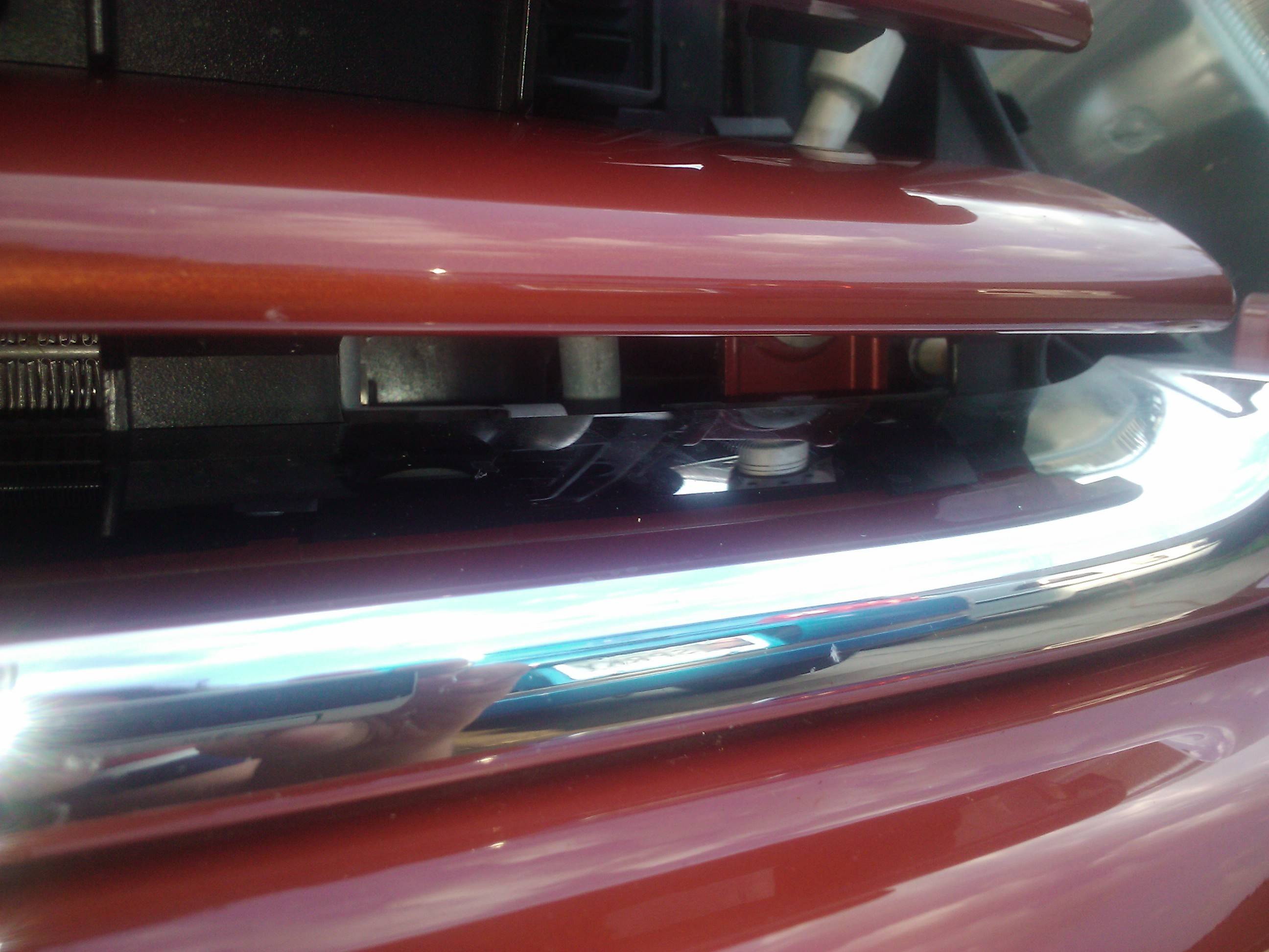

The main issue I am having is my car has the Aero body kit with the painted slat grill, which I want to keep, and all the pre-cut grills are either Cooper chrome, or the MCS black, so I wanted to make sure the OEM style brackets are still compatible, and if they will have a cutting diagram if required for the slatted grill, or where I can find one.

After looking closely at my grill, I think you're right that the factory brackets should fit; the grill is completely open where most diagrams show the cutting to be, you can see the orange bumper mount through the slats.
