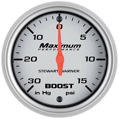

Hi all. I'm thinking of adding AFR (Air Fuel Ratio) and boost guages to my R53. I'm in a real nead of an expert opinion. I need to know:
-Where to get best AFR sensor and cables.
-Where to get best AFR guage that matches our R53 silver interior.
-Any recommended boost guages?
I'm thinking of the Stewart Warner boost guage as it matches the car's interior.
Any help in this project is highly appreciated.
