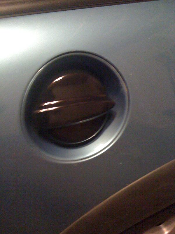

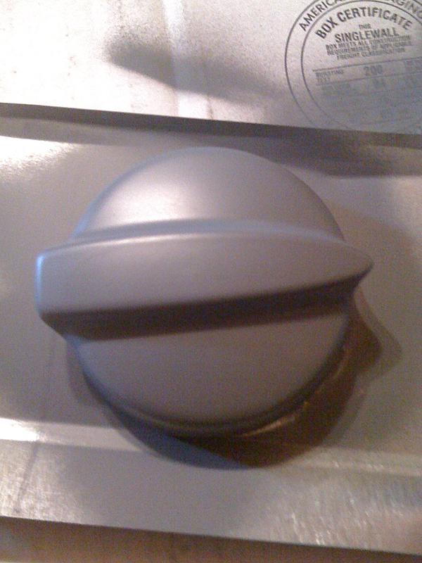

A long time ago I had a Wrangler. The previous owner had installed chrome brush guards, grille, head/tail light cages... The works. I sprayed over it with Dupli-Color Truck Bed Liner. It wore like iron wrapped in carbon fiber and dipped in titanium. I rammed a guard rail, bent the 3" chromoly tubing. Not a chip or scratch. Yet the same stuff didn't last 10 minutes on the gas lid. This seems to work. My only complaint would be that it was a bit higher gloss than I'd hoped. But, after a break-in and subsequent annihilation of my dashboard, it will be a while before I can really road test it, or you know, drive it at all. The pics were taken with my iPhone. I didn't dare sneak into the bedroom at 3:00am to look for my digital camera and risk waking the sleeping beast. I mean, my beautiful girlfriend of four years (tomorrow).
As a general note, I didn't notice that the temp slipped to about 29 last night, and it really jacked up the adhesion on the plastic down tubes I was also painting. But it didn't seem to affect anything on the metal gas door.
