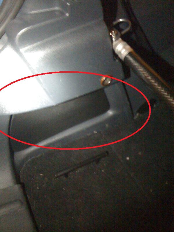

Okay so it has been a while. You still probably want a deep-well socket, but a ratcheting wrench will work well too. It is 10mm. Just one bolt/nut. It is behind the panel in the back side. Once it is loosened the tail light needs a jiggle. on the side opposite to the bolt is a metal retaining clip. Hope this helps!
The pics suck hard. All I had was my iPhone and a flashlight, but I think its enough to help you out.
