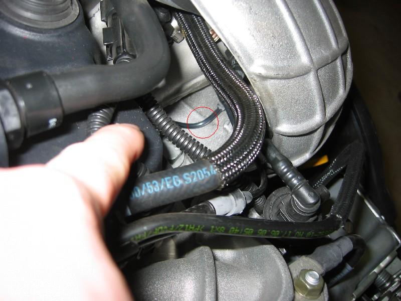

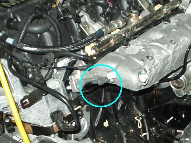

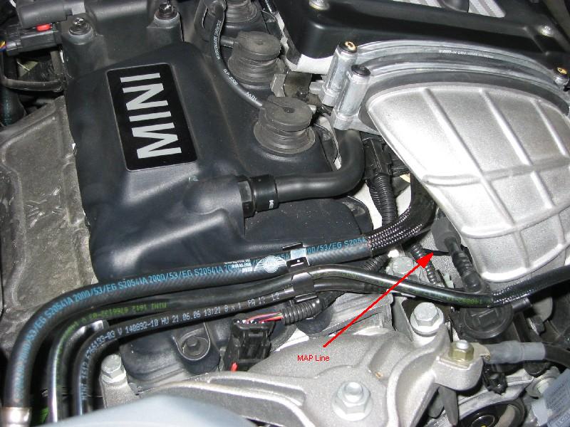

I used the Alta website instructions/illustrations to place the T fitting into the MAP line on the passenger side under the intercooler. Here are some of the pictures that helped me.

yep wrong hose fixed it on fri night @1 am. thanks for the help!
