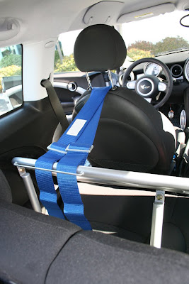

Our harness bar is in. We're sorting some final details but it is truely a bolt-on requiring no modifications. It can be easily pulled out after your trackday/autoX. It is massively strong and secures to 5 pts on the chassis. Check our Blog for more info.
Needless to say, I am ecstatic! We're attaching the same Schroth ASM 4pt harness we sorted for use in our Lotus. This bar works with the stock seats. If you are interested in this bar, please contact me.

Do you have any pictures of how this works with the stock seats (w/o the pass throughs I assume). Thanks.

That looks great, you should extend that bar across the top, and make it a nice hoop. Then, I bet it woudl be good for most track days.

Here are some more pix after painting it and installing the Profi II ASM 4pt.
Productions bar will be powdercoated black. Note the rear seat bottom fits back in - for those AutoX guys that require it. The seat travel is excellent even for tall drivers.

Our intern, Bill is 6ft 5" and he fits great in the MINI with our harness bar in place - the seat still has additional rearward travel.
The pix below show how far back the seat can be placed.
