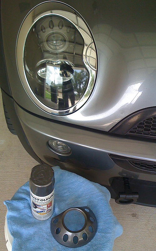

Shooler,
Thanks for the info on the J-Mod. Looks good.
Forgive the iPhone pics. For those of you with Dark Silver Minis and on a budget, go to WalMart to purchase your paint. (If using Drk Silver) As you can see on the attached pic, Rustolium Metalic paint is very close to the Mini OEM paint.
I was told by "Shooler" to be very patient. I now understand why. If you hear cracking and popping your moving to fast. Yes! Use a heat source to warm up the black rubber seal/adhesive. Do not remove any of the light assembly. If you remove the low beam bulb you'll see 1 each tabs on the Lt & Rt (gray colored plastic) behind the metal heat shield (?). Use a 4-6 inch flat head screw driver to release one of the tabs. After-which the half moon projector lens cover should pop off easily with a little prying. I removed the whole right side light assembly and wasted a lot of time putting it back together.
Oh! Still waiting for my body colored headlight rings.
