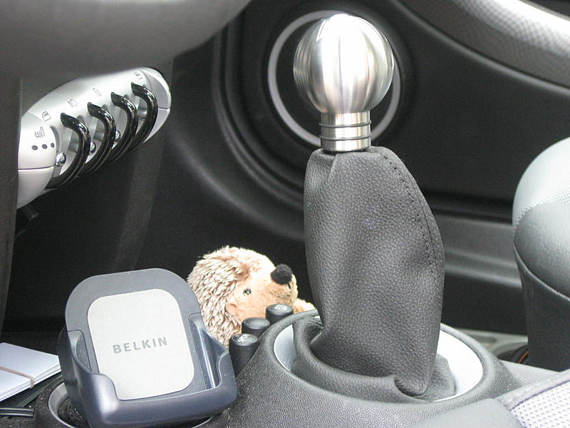

Hi Gents,
OK, I finally got my WSM installed. It took the strength of my 275-pound buddy to pull off the old ****, I kid you not. But it's off and the WSM is in. Nice!
I was wondering if someone could tell me if the boot is supposed to articulate with the ****, or if the boot just runs adjacent to it? See the pic:

Originally Posted by Halifax
Hi Gents,
Your pic looks like the ring at the base of the shift boot isn't fully re-attached, and that could be a good thing, because you can adjust things a bit while it's loose...
Did you do anything to tighten the fit of the boot top so it won't slide up & down the rod? When I installed my WSM I found the original "washer" (the part into which the shifter ****'s clips are secured) inside the boot didn't hold the boot up very well, so I put a zip tie on the inside and made the top of the boot securely flush with the bottom of the WSM.
You may want to try this:
With the boot ring detached from its base and the WSM fully secured to the shift rod, fold just enough of the boot top into a zip tie (underneath) and tighten the zip to secure the boot material to the shift rod, snug against the bottom of the WSM. The zip will be out of sight, and you'll have a smooth transition from the WSM to the boot. The only caution I can offer is to not "fold in" too much of the boot material; leave enough slack so you can use all the gears without straining the boot. The boot base ring should be more fully inserted than you pic shows; it will positively "click" into place, and there will not be any gap between the ring and the gray plastic of the base surrounding it.

OK, very good. So I take it that the collar on the WSM itself is not tucked into the boot. I'll also get that trim ring at the base of the boot re-seated ... I didn't notice it being up until you mentioned it

Where the boot meets the ****, mine looks just like yours. I considered rigging something up so that the boot would remain up (as it isn't currently attached), but it seems to stay there just fine on its own.
yeah mine stays up too but i didn't like how it kind of flops back and forth and is never entirely centered. I ended up putting on the shifter shaft 4 garden hose washers and that seems to do a decent job of sandwiching the boot to the bottom of the shift ****.

Originally Posted by minikart4me
I just installed my Whalen Shift ****, my only question now: Is the shift boot suppose to remain almost free floating or is it suppose to snap back into place some how?
The boot stays floaty, but if you look back in the WSM threads, there have been a few ideas advanced as to how to get keep the boot connected to the ****, if it makes your install more to your liking. Enjoy the WSM .. it's great, isn't it?

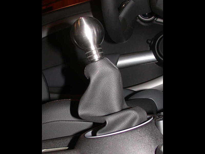

no fooling: i struggled for 30 min and then called the dealer to ask how to get the &%$#@! thing off, and he said:
-- unsnap the shift-boot-ring at the bottom,
-- open your sunroof if you have one,
-- take your shoes off and STAND with one foot on each seat, and
-- PULL STRAIGHT UP.
That's the ONLY way mine was ever gonna come off ... but the new Whalen is WAY worth it. (Thanks, Doug!)
PS: I arrived at the same conclusion as AltoClef, trial and error: turn the boot inside-out and upside-down on the end of the shifter, zip-tie the last half-inch of boot (small opening down) about two inches below the top of the shifter, and turn the boot right-side-out gently as you lower the ring back onto the shifter ... plenty of slack left to snap the ring back to the console, and the boot-top is tight and tidy to the bottom of the ****.
