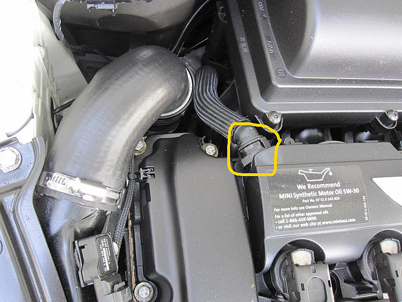

considering the chemical make up of this stuff I used a rubber glove to cover most of the hose opening and poured in slow. just do it.

Yeah. Squeeze tabs on hose ring and remove from engine. Add Seafoam to hose, very slowly and carefully as described elsewhere.
I did it. Not a lot of smoke. Hopefully this will help the rough idle. We'll see tomorrow. I did my Honda Element earlier today and it smoked like crazy!!

Hey guys. I slowly poured in 1/3 the bottle but accidently plugged the hose back in before I turned the car off. After I started it up 20 minutes later the CEL is on and no smoke came out at all. Do I need to bring it to the dealer? Did I do damage? And can I try again properlytomorrow? Thanks!

even if you didn't get smoke, the mis-fires caused during the treatment, the vacuum leak from having the hose unhooked, and the engine seeing un-metered air are all going to throw faults... even if your light doesn't come on, there are likely soft faults &/or shadow faults stored. After any treatment it's best to check & clear the faults, if they come back on again, then look into it further..
As for your transmission fault, if it's an automatic, it's tied to the ECM and can be triggered when the ECM sees some bad signals & relays them on to the transmission module.

Tbangin 23: Check engine lights are common after Seafoam due to the misfires and disruption in normal operation. They almost always self clear. I would just drive it for a couple of days and see if the code clears itself. Continued driving without any more missfires will allow the computer to reset. You know that what you did caused the code, have faith and wait, it will self clear. Taking it to a shop or the dealer right away will just waste your money and time.
3one3: Try doing Seafoam again tomorrow. Nothing was damaged. Doing it twice cleans it better anyway. Drip it in more slowly than the first time and wait 30 minutes to restart. The above advice on codes/check engine lights also applies to your situation.
