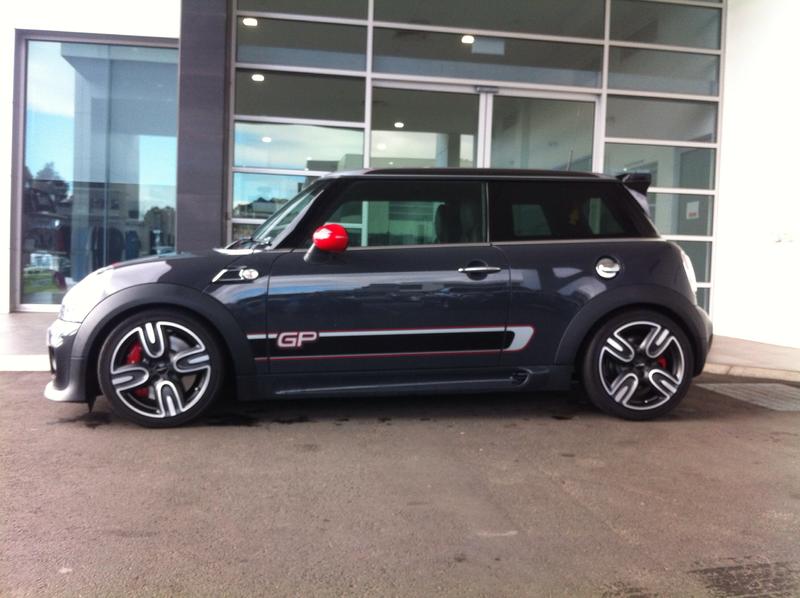

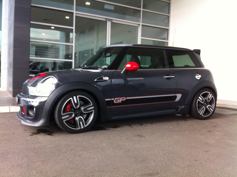

Hi guys, finally got around to lowering the gp and corner balance it. I had driven the car for the past couple weeks to get a feel for it prior to lowering to see the difference. Since I use this as a road car most of the time, I didn't want to go to the lowest setting so decided around 15mm would be good. There is 21mm of adjustment. Without anyone in the car the diagonal corner weight is very balanced from standard factory setting, we adjusted the balance with my weight in the car to get it right for me. In the end we lowered the car 18mm at the front and 14-16mm on the rears to get it balanced. Car with a full tank, fire extinguisher weighed in at 1183kg.
Been driving a couple days to get a feel for it, through the twisties and everyday normal roads and I can't say I notice a difference. I have no electronic data as I haven't tracked it yet but seat of the pants says it feels pretty similar, which is a good thing. Only thing that I've noticed so far is the plastic lip in front of the tyre now scrapes on big bumps, and the car looks slightly better.
I'm off tomorrow morning to re check the alignment to see if there has been any change, if so I'll have the alignment done as close to factory settings as possible as I love it this way.
