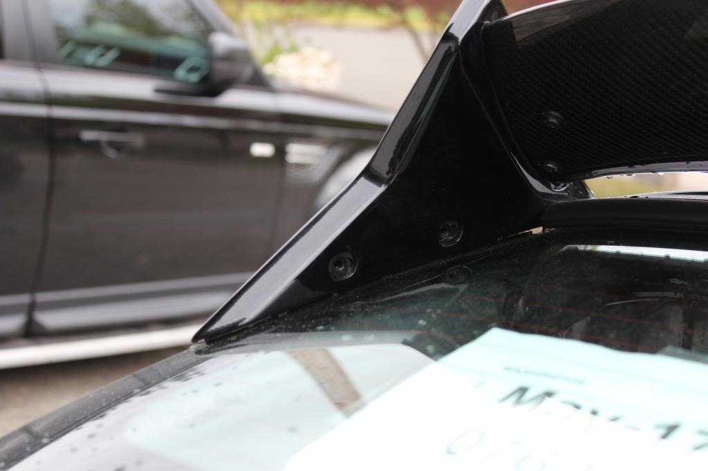

there was the question of whether or not the rear spoiler would need the rear glass replaced for it to work. I think this stemmed from Mini parts dept showing the GP specific "rear wiper delete" glass... I confirmed that the glass has nothing to do with the spoiler. I removed my spoiler to get the facts.
The spoiler supports mount to the glass using a removable "C" channel bracket. The top secures to the roof just as a standard spoiler would mount- to the hatch using 5 10mm nuts.
Pictures are worth a thousand words so here we go:
removed these 4 torx nuts first- two per side:
