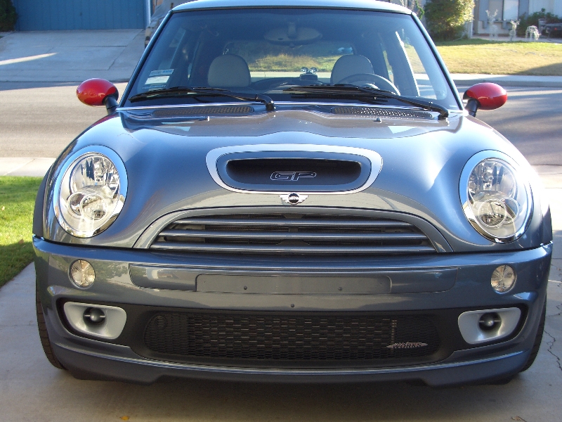

I have attached some pictures of the GP bumper and license plate bracket.
Here is the GP front bumper with the license plate bracket removed.

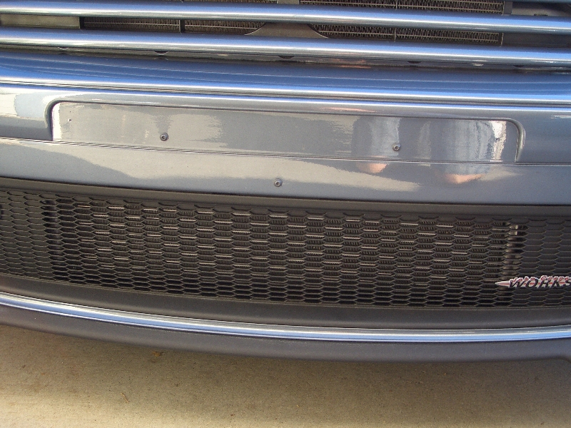

Here is a closeup picture of the front bumper. You can see the three screws that I painted and reinstalled in the bumper to fill the holes.

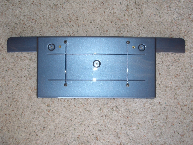

Here is a picture of the license plate bracket. You can see the four screws that hold the license plate frame. These are the four screws on the two verticle and two horizontal lines. The three screws that hold the bracket to the bumper go through the three larger holes on the bracket. The two holes with gold inserts are not used. The velcro strips are on the two "wings" that stick-out on each side at the top of the bracket.
To remove the bracket. Remove the license plate frame. Remove the three screws attaching the bracket to the bumper. Pull the bracket off the bumper carefully separating the velcro under the two side wings. The velcro strips remaining on the bumper can be easily pulled off the bumper. I painted the screws with dark gray primer and clear coat. I reinstalled the three screws in the bumper to fill the holes.
