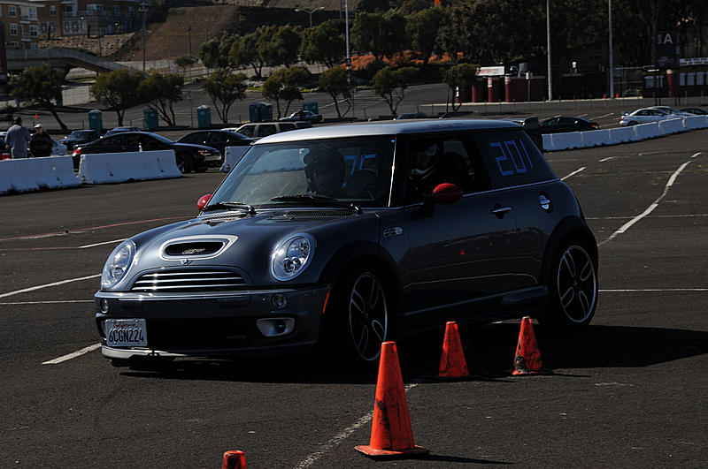

I'm in the same boat, wanting a set of tires/wheels for my GP for trackdays and autocross. But on top of all this fun, I'm a cheap bastard. What's the best value in wheel/tire combos for autocross?
(Pick from Sunday's BMW autocross at Monster Park...)
