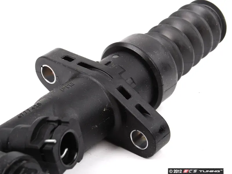

is there a trick [solution] to stop a leak from where the pipe [line] goes into the clutch slave cylinder
my R52 cooper S JCW has a slight drip coming from the push in connection, I even tried fitting a new slave cyl which leaked worse, is there an internal seal either in the cyl or on the pipe?

Hello,
Its the O-ring. Whats happens on install is it can pop out. Make sure the oring is installed in the unit inside the output cylinder.
https://www.realoem.com/bmw/enUS/sho...diagId=21_0178
Pipe: https://www.ecstuning.com/b-genuine-...e/21526759854/
Output cylinder: https://www.ecstuning.com/Search/Sit...h/21516777428/
Look at your end and compare to ours.
