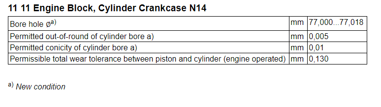

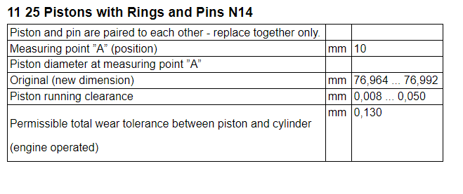

Find a new shop. The spec for total wear is 0.13mm or 0.005", assuming the material is the same as the OEM pistons.
Here are the OEM build specs:
