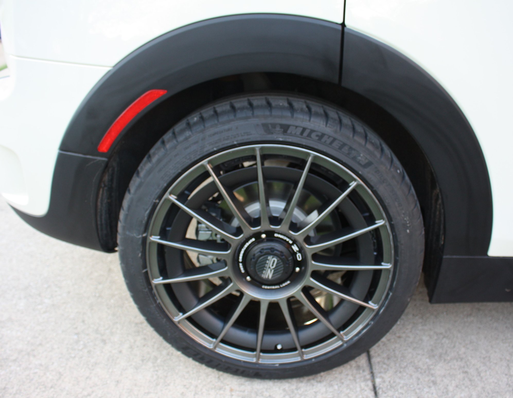

New Wheels OZ & Switch Runflats for Michelin Pilot Sport 4s
Truly I didn't feel like I would be able to tell a difference between run flat and regular tires. I assumed only trained drivers or serious car enthusiast might feel the difference........I was wrong. From the first day, the ride felt funny. There was a bit of skittering over the road instead of feeling planted. The ride was uncomfortable to add to it. I can accept less comfort if it is a result of a performance enhancement. But without one, what is the point?
Yes Minis are small and run flats allow you to eliminate the need for a spare. But they are used on all models, not just those which have issues fitting in a spare. I had opted to purchase the spare when building my Clubman. It was only $100.00 which is considerably less than purchasing it with the items needed to change later.
I had ordered the all weather version when I built figuring that I could use them during the few months when you actually need a cold weather tire in Ky, So the tires are saved in my garage and may be used next winter,
I wasn't planning on buying wheels, but I wasn't crazy about the wheels offered by Mini and wanted either a darker color or black to match the trim elements on the car. After more research than I want to admit to, I ended up with the OZ Aero in graphite color. This is a new style for OZ and are both fabulous looking but also serve to introduce cooler air over the brakes.
Universally the Michelin Pilot Sport 4 S were recommended for summer/warm weather use. I absolutely love them and would recommend them highly. You really feel planted on the road. There is no skitter feeling in curves or on changing road conditions. They are quiet. Check with Michelin before you purchase as they run promotions
New O.Z. SUPERTURISMO AERO HLT STAR GRAPHITE Wheels with Michelin Pilot Sport 4S.
constantly and you can get a good rebate back if you wait until a promotion is offered. On mine I am getting $75.00 back as I purchased a complete set of four tires.
These tires are rather limited in smaller sizes. There are only a few 17" ones offered, but more are available the larger size you get.
If you have them what do you think? Anyone have a bad experience with them? Anyone think there is a better choice in the market. Anyone a fan of the run flats? What is your favorite tire and why is it your favorite?
Answers to these questions will help others who are just starting the process of switching tires.

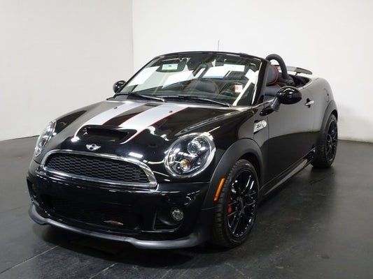

R59 JCW Roadster 2015: Chrome removal
If you have a black Roadster are you a fan of blacking out the chrome? Initially thought to leave it but as wheels were black thought I would try it first around the beltline with the extra tape I had. I loved it. Although my skills on the beltline trim need improvement which means I need to redo both cars, I ended up:
-Beltline trim in piano black (hairdryer, extra pair of hands and watching a few YouTube how to videos strongly suggested)
-New grill trim and grill: In this case I had the choice of purchasing completely new grill and trim or just purchasing grill trim covers as the grill was already black. I decided to purchase the complete set. Issues? Oh yes big ones. There were no instructions provided and the only instruction on the listing was to remove the 4 screws from the top piece of grill trim which affix to the bonnet. Needless to say that was far from complete and when I called to ask about the little tabs which were in each slot across the grill trim, I was told to go down to bare metal as otherwise the new trim piece would not work. In order to remove them I ended up breaking most of them. Unfortunately if not the original clips, some clips are necessary for the upper grill trim to be secure. While mine is being held in place by the 4 screws, it will wiggle and it will drive me crazy, which means I will have to come up with a fix. I purchased this from NorthAmericanMotoring. The owner is great about answering questions and providing information where needed.
Next tip on the grill/trim removal: put a large blanket or towel over the engine bay. That way if you drop a screw it is not lost somewhere inside. It also provides a shelf of sorts to hold both tools and a flashlight to aid in seeing what you are doing.
The new grill was shiny black in contrast to the the original one which was more matte. As I had also removed the bottom grill trim incorrectly (you don't just take it off with trim tools like you do with trim around the headlights for example), I opted to replace both the bottom trim and grill. It looks so much better so that was a lucky outcome.
-Door Handles: the boot already had a black handle so I just purchased clip on door handles from the same UK company who had sold me the ones for the Clubman. (KillAllChrome) Other choices for sale werre ones in Carbon Fiber. Simple and easy install. Clean handles with rubbing alcohol, remove tape over sticky parts in the handle interior, press onto handle and hold firmly for a bit and it is securely in place.
-Headlight and Taillight Trim: If you have plastic trim tools which I strongly recommend to protect the car from scratching, these are a breeze to remove. The first "crack" made me jump but as I was moving slowly, I tried to not freak out. There are a few places where there is a clip that must be released and it will crack as if breaking. Watch YouTube videos to see how to do this easily and without risk to the clips. Some recommended taping around trim before removal to protect paint, but at this juncture I had removed so many trim pieces that I felt confident with the plastic trim removal tools and didn't do so.
-New Union Jack/Flag rear lights: I purchased mine from ECS for less than $300. and love them. Again NO instructions were sent and I was left looking for a YouTube video which would show me how to do it. The hardest part was removing the screws! One YouTuber did it with a socket/ratchet which I have tons of, but none of mine would fit. It wasn't until I watched the Petrol Ped video that I found you need a torque screwdriver (the ones that have a rather star shaped bottom) in a 20mm size. Mine was 5mm smaller than what was used by PetrolPed, but the 15mm one did work and the screws were removed. Getting your hand back into the space behind the lights is tricky. I would do the driver's side first, if you are right handed, as it is a bit easier to manipulate and will make the other side which is a bit awkward to reach easier.
Tip: Check prices everywhere and make sure you look at them working in a video. Some have a progressive LED strip for the turn signal, others do not. They come in red or a smoke grey cover. I went with the red simply because there are elements of red trim on the JCW which I didn't want to completely eliminate like I did the chrome. If I had it to do over I think I would have gone with the smoke because of the side scuttles installed.

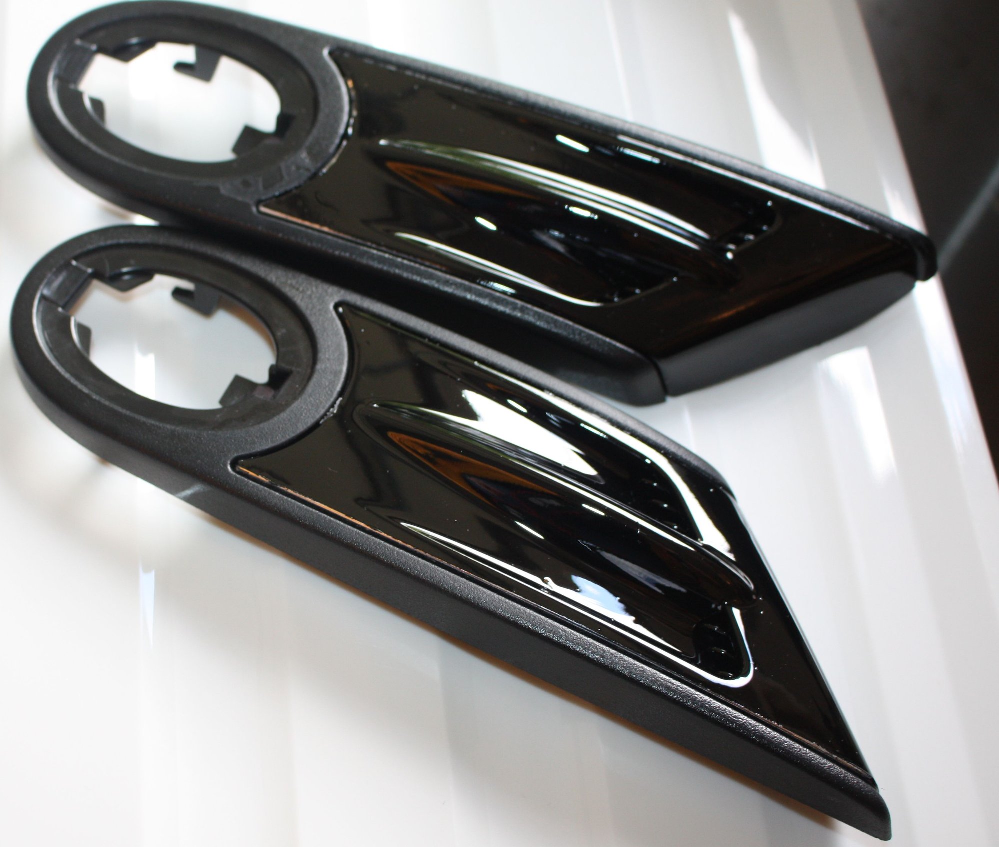

-Side scuttles and turn light: My scuttle had a chrome insert into the black plastic housing. The light was amber in a clear plastic cover. I went with a smokey light cover with a progressive amber strip when the turn signal is activated. I had purchased new all black side scuttles but the black housing just didn't look right against the metallic black paint on my car. I decided to just tape off the housing and spray paint the part that had chrome. There are again a lot of videos but try to find one on chrome trim rather than on wheels.
Tips: Take a higher grade masking tape to mask off the areas that are black.
A coarse grade sandpaper was ineffective in roughing up the surface of the chrome, so I applied an adhesive primer intended for chrome. After you apply it will look rather like paste wax does before you polish it out.
Apply multiple coats if recommended by the primer/adhesive you are using and make sure to wait the recommended
time between coats. I used Dupli Color products for all of this project.
Select the spray paint intended for automotive use and note there are finish options from shiny to matte.
After you have finished your coats of spray paint, apply a clear top coat. I was looking for a shiny finish to match the
piano black and I think I was successful. Had I known how easy this process was I may have just spray painted all the trim (headlights, taillights, grill) rather than covering or replacing.
Antenna: There was nothing wrong with the antenna as it came other than I have grown used to smaller ones or have had seen cars with no antenna and instead had just the "fin" type. I bought mine from Craven Speed. It was so easy to install. It came with a couple different sized interior parts and was easy to pick out which one I needed for it to fit my Mini.
Overall TIp: Pack up and retain every OEM part which you remove! I padded everything and placed them in boxes clearly identified as containing the OEM trim. That way if the next buyer prefers another look or you grow tired and want the chrome reinstalled, it is simple matter to do so.
Photos show the car at the dealership where I purchased it. It only had 13k miles on it so was in very good condition. A friend said I was looking for a unicorn. My unicorn would be a JCW, fully optioned, low mileage and reasonably priced. No one was more surprised then me when after looking forever, I found her!
My Unicorn! Low milage, JCW Roadster, fully optioned and at a reasonable price as she looked at the dealership.
Spray painted chrome accents on side scuttles.
Replaced clear lamp for a smoked black one with an amber progressive LED light.
Replaced chrome around headlights, grill and complete new grill.
Door handle covers in piano black and new stubby antenna.
