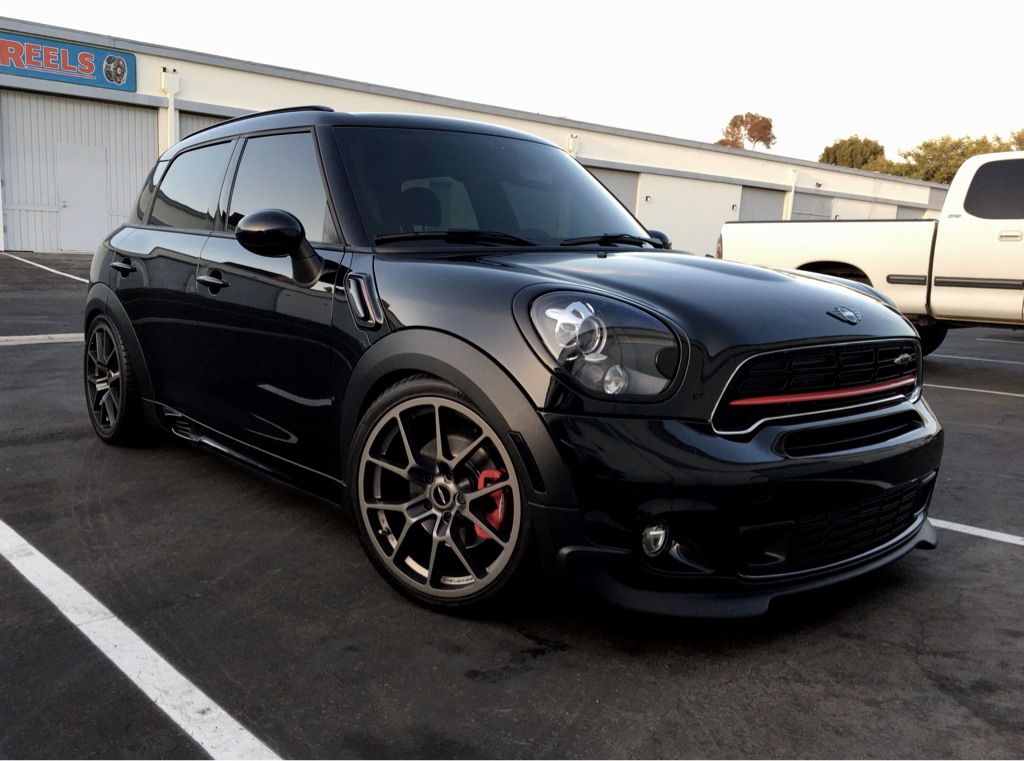

I was able to code my CM mirrors to fold and open with the fob.
