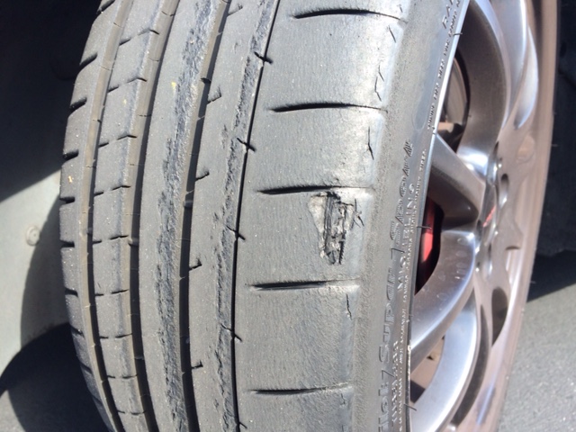

Thanks much for all the feedback. I've initiated a conversation with BR Racing regarding front camber and toe and the best way to go about it. We'll see where it goes.
Just for the heck of it, I'm going to try to post a couple pix of my tires. One of the left front which got all the abuse and one of the right front that looks pretty good. (I think; you tell me.) I noticed the damage to left front at the end of the day on Sunday. I believe it happened late in the day Sunday as I was checking the tires all weekend. Total track time on the tires is 4 solid hours. (Twelve 20 minute sessions.)

Wow that left tire is toast.
You are rolling over onto the sidewall. Look for the sidewall marker on the right side tire and compare that to the left side tire where the marker are probably worn off. One fix for that is to raise tire pressure. The other is to increase camber. My ZIIs have gone 3 seasons for probably 15 days and they don't look like that. This is just another reason for going to an extreme performance tire.

Yea, I definitely didn't run enough pressure in there. And combine that with the hard right turns at Searspoint in 2, 3a, 4, 7, and 11 and it's not surprising I toasted the tire. Oh well. That's the only damage I did and I've got two new front tires on order. And I'll likely be getting my front camber and toe in changed before my next track outing. Ya live and learn.
