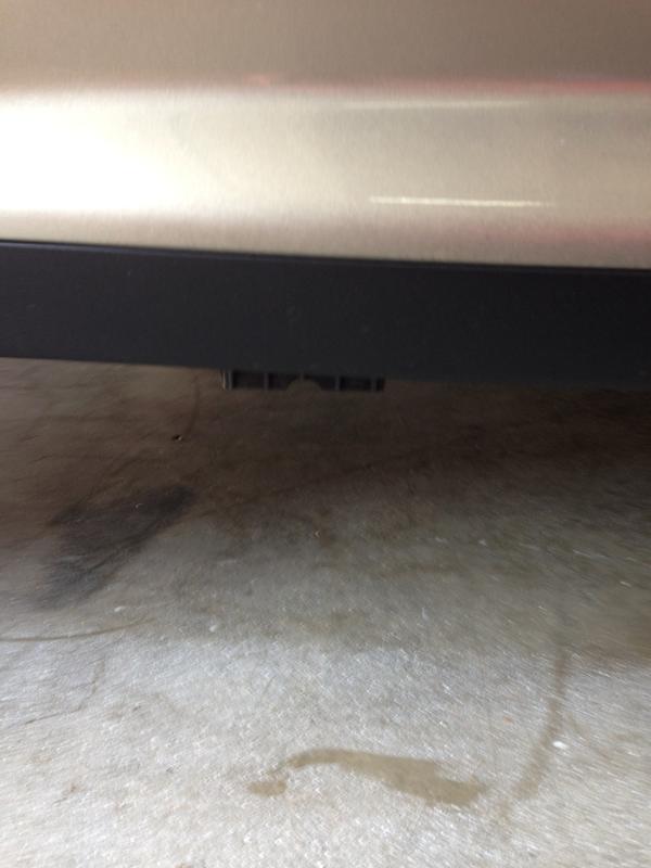

My wife bought a 2011 MC Clubman, Sparkling Silver/Black roof. Found out through another post that it has the Hyper Sport/Sport Aero body option. I would like to paint the wheel arches and the black plastic under the rocker, body color. I have found Spay cans of paint at Automotive Touch up along with other supplies i need. I don't want to remove the trim unless necessary. I can mask the body off as needed and feel I am skillful enough to do the painting. Would it be better to remove the pieces and paint separately or leave them on the car. Would it be better to just bite the bullet and take it in to a body shop and have them do it. Any advice or opinions would be appreciated. I hate this black plastic trim that is used on cars now. It also it would make the wheels/tire I will put on later look better. Living where I do in California I don't have to worry about winter driving as we don't get snow so no salt/sand to worry about.

Bite the bullet. It needs to be removed, cleaned, sanded, adhesion promoter applied, primed and the painted. Yes, all those steps are necessary. If you don't, the paint will fail, and peel off.
Better yet, buy new trim and have that done, then install it. By this time, the trim has probably had all sorts of dressings put on, that are all but impossible to completely remove. Paint and silicone don't play well together.

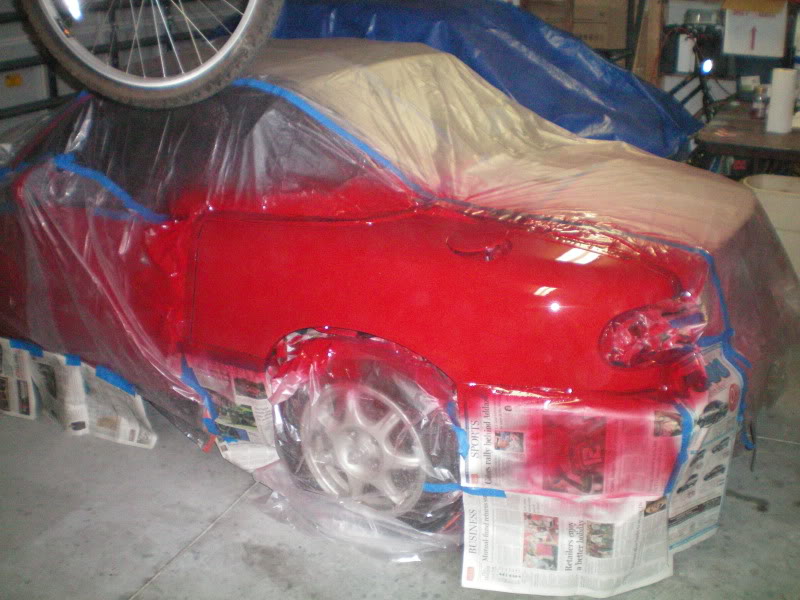

1. The wheel skirt parts are not smooth so you have some surface prep to do assuming you want a smooth glossy finish ....
2. Shooting automotive paint isn't rocket science but few find their first experience to be factory quality either . . and the materials ain't cheap. Practice makes perfect.
3. I found an adult education class on body repair and painting ..... VERY HANDY .... all the equipment, a proper spray booth and an instructor . . cost me $120 a semester. In truth it wasn't a class but supervised access to the local HS VOTEC auto repair lab . . . which brings up part two .... sometimes you can get these students to do the work for you if you just buy the materials.
p.s. watch out for the heated workshop ... spray paint fumes and overspray create an EXPLOSIVE atmosphere . . . you CAN blow the whole place up. It CAN be done but BE CAREFUL
here I'm repainting the fender on a Miata in my garage
