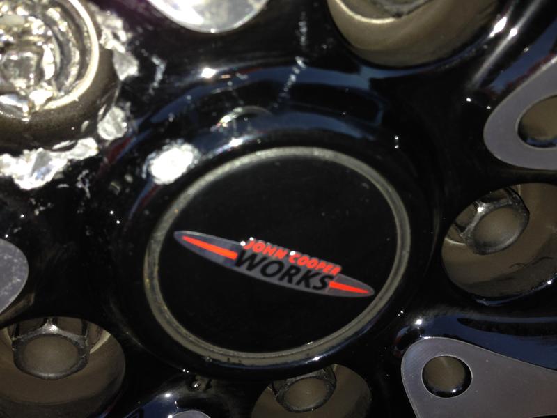

I attempted to put on my winter wheels on this weekend. But as I began removing my MINI branded locking lugs bolts the wheel key lock seems to have stripped/bent when I was on my third wheel lock.

I thought I would provide info on how I finally got my wheel bolt lock off.
First attempt, I ordered replacement keys from McGard which manufacturers the MINI wheel lock sets. Those replacements did not work as the key kept slipping off.
Second attempt, I scheduled an appointment at the dealership so they could get the lock off. McGard fedexed me three additional locks so that the dealership could use their impact wrench/gun to get the lock off with the following instructions.
Removal of overtightened Lock Bolts--Instructions from McGard:
1) Overtighten ALL lug bolts on the problem wheel to remove the pressure from the lock bolt. Do not overtighten to the point of stud or lug bolt thread damage.
2) Remove the lock with your key. When using hand tools such as a lug wrench, ratchet, etc. direct inward pressure on the key must be used. This will keep the key pattern firmly and squarely engaged into the lock pattern. Normally McGard does not recommend the use of an impact gun, but if the key is not attached to another object (some McGard keys are equipped with a plastic or steel cable) an impact gun does work best for removing overtightened locks. If using an impact gun, the lock may not come free immediately. Continue using the impact gun as the repeated ratchet motion will slowly loosen the lock.
If the lock does not free after a few minutes, try to remove the lock using a ratchet or breaker bar, (making sure to keep direct inward pressure).
3) If the lock does not free itself, loosen one lug bolt (4 hole wheels) or two lug bolts (5 hole wheels) opposite the lock and repeat step 2.
4) Upon removal of lock, remove all lug bolts and remount the wheel.
Unfortunately, that did not work and the dealer broke an impact socket trying to get the lock off and damaged the wheel. I had to come back once they ordered new wheel.
Third attempt, McGard then recommends a drill out kit for the lock. The three cobalt drills to use are 1/4 inch, then 3/8 inch, then 7/16 inch for the CM/PM 14 mm bolt (not 1/2 as image shows).
See image:
1) Place sleeve #1 over the lock.
> Ideal speed is 200 RPM max (over the phone they recommended 500-600 RPM).
> Start drilling with the 1/4 inch drill into the lock (20 mm deep)
2) Repeat step 1 with sleeve #2 and 3/8 inch drill.
3) Repeat step 1 with sleeve #3 and 7/16 inch drill (image shows 1/2 inch which is too big)
> After the third drill, the bolt head should fall off. If not, the drill was a little off center. A tap on the bolt head should break it free.
Unfortunately, the lock got damaged in the process so they were not able to drill out (see photo). As a result, the dealer heated the lock up and broke it free. Whew! Very grateful to the dealership for getting the lock off!
