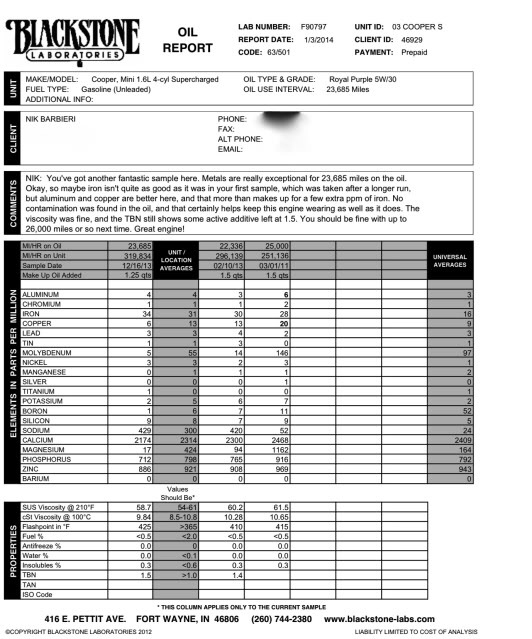

Do what makes you happy.
Nik

WOW!, thats impressive......i know modern oil is robust, but 23K on the same oil with a green-light from Blackstone......never would have guessed.
how are your driving habits?
