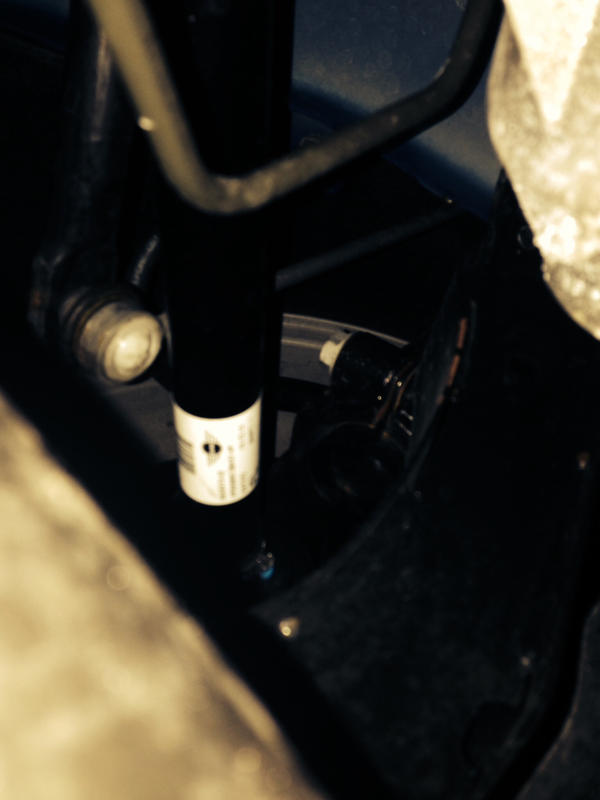

Hello everyone!
So far so good. No sweating or leaks (fingers crossed).
I did notice this rod-like part (looks brand new) going from what I believe may be the transmission to the driver's side tire. It has these rubber boots, and looks very much new. I'm assuming that's the part they replaced.
Time to motor -- on my way to work.
Regards,
David
Sent from my iPad Air using NAMotoring
Attached Thumbnails Any suggestion(s) from the more seasoned MINI owner?-image-286540184.jpg   Any suggestion(s) from the more seasoned MINI owner?-image-1469325469.jpg
Old Apr 30, 2014 | 05:37 AM
  #30
v10climber's Avatar
v10climber
Joined: May 2013
Posts: 1,394
Likes: 19
From: FL
That would be the drive axle.
