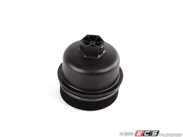

Yep,
Cooper S , SX ALL, and JCW ( N18 engine) down under the coolant tank near the turbo. Same location on the NON Turbo Countryman Cooper ( N16 engine) ( just no turbo above it ). Little easier to reach.
Look for the back housing Cap , the filter clips to the bottom underneath :
http://www.ecstuning.com/Search/SiteSearch/11427557011/

And you will need a 27mm socket for the cap.
