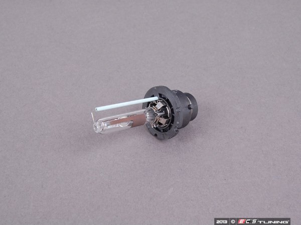

Here are the D2R Xenon bulbs :
There are some other cost options. Part # 63126907495
http://www.ecstuning.com/Search/SiteSearch/63126907495/
