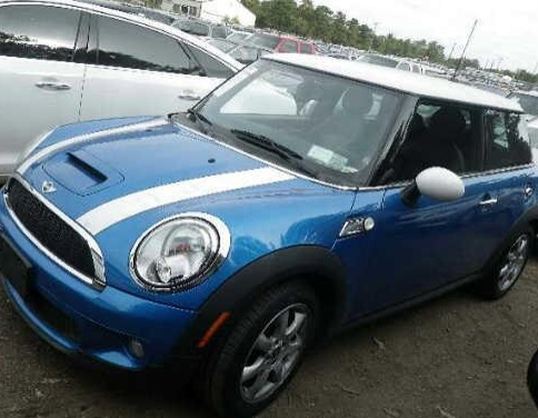

workin on getting a '08 S mini
only 43k on her clock...any issues on this year I need to watch for?
