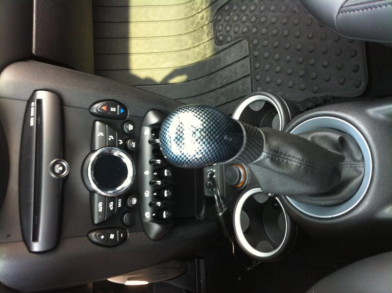

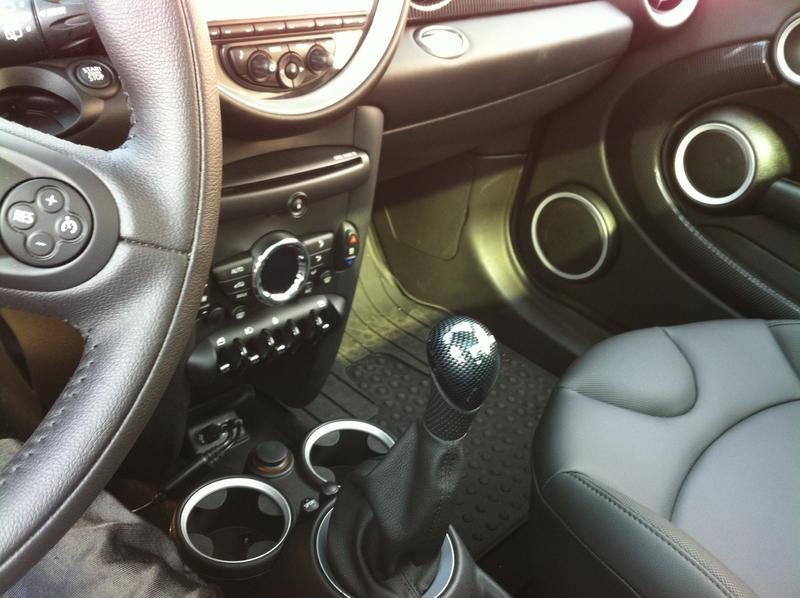

So with the aid of my laziness in returning the MOMO ****, the aid of the users here and the aid of my brother I was able to get the **** on!
I attached pictures of the **** in the attachments, looks pretty good and feels nice too.
Ended up being not STITCHED but rather a weak glue was used to hold the shift boot together with the shift ****. Don't ask exactly how I did it, I took out the whole console, then took the shift boot itself off that console then played with all the involved pieces until it finally came off. Traumatized forever now haha
