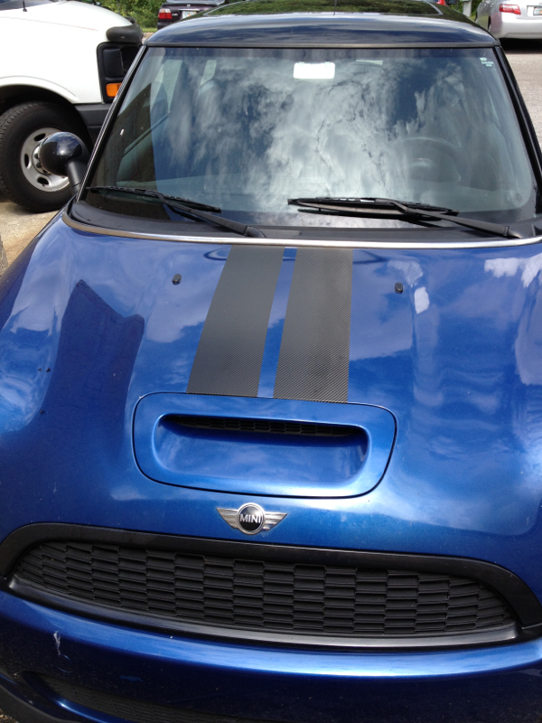

I replaced it with 3m 1080 carbon fiber wrap. It was a ***** to cut the stripes perfectly straight. I recommend using a large paper cutter.
I took awhile to remove my old stripes. But with wd40 and a little bit of patience, it came off smoothly.
