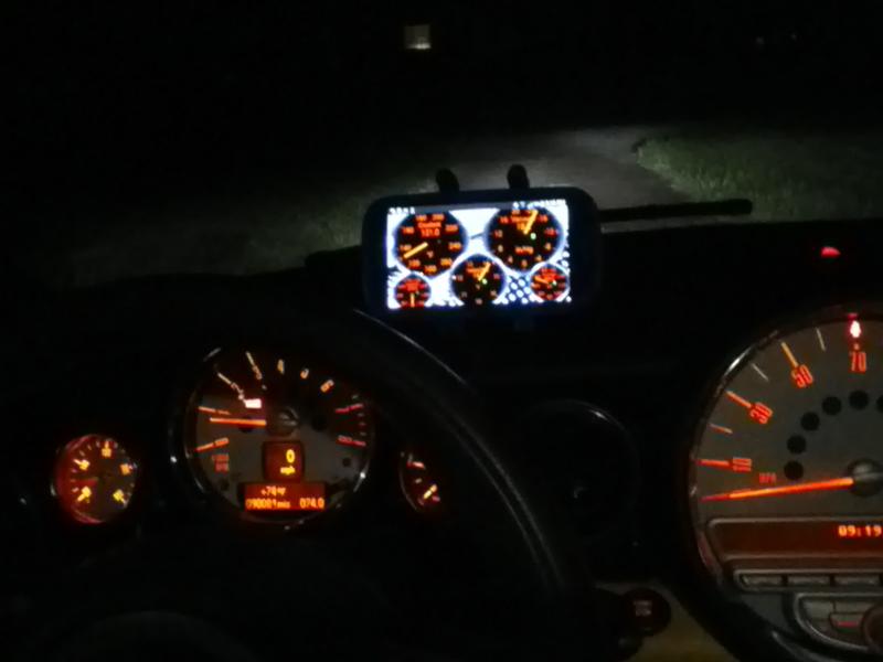

It is a great app. I've been using it for over a year on my Galaxy 3 phone. I have attached a picture but I admit it's not very clear. I have engine temp, vacuum/boost, turbo temp., voltage, and fuel rail pressure.
The one thing that is lacking is oil temperature or oil pressure but that seems to be due to MINI not having a sensor to read. If anyone can figure out how to get either one of these on a N14, please post directions.

How did you get turbo temp?

I am using the Catalyst Temperature (Bank 1, Sensor 1) sensor which I believe is the oxygen sensor directly after the turbo. It is measuring the exhaust gas temperature coming from the turbo.
Years ago I drove trucks with Cat, Cummins, and Detroit Diesel and you always idled down the engines before shutting down. This allowed the engine and turbo to cool so the high temps didn't harm the engine.
So basically I usually try to keep my foot out of it a few miles before I park the MINI and when I do stop I don't shut the engine down before the sensor is below 1,050 degrees. I had been trying to let it down to 1,000 degrees but i guess I'm too impatient
