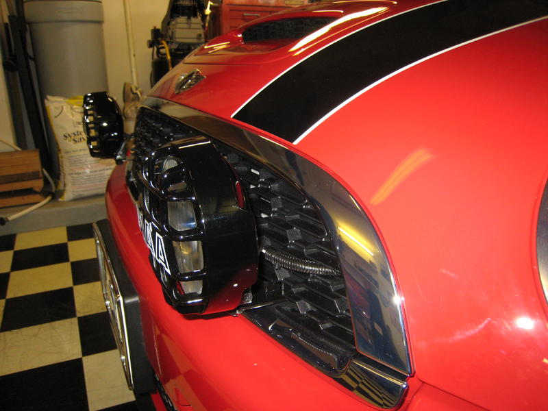

Just added these to my MINI.
Attached Thumbnails PIAA 540 driving light photos-img_4366.jpg   PIAA 540 driving light photos-img_4345.jpg

Nice!! Looks good with the black of your car!

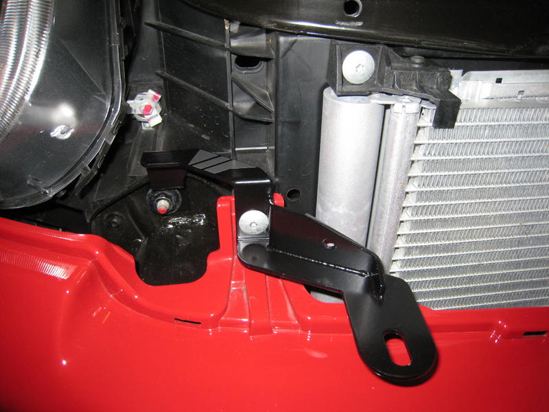

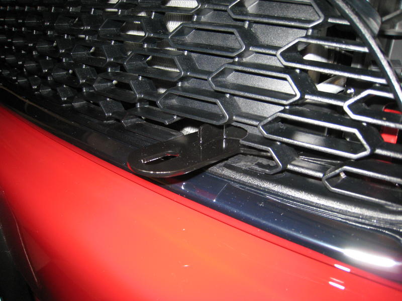

It is a very easy install. The brackets are from VIP customs in Arizona and the PIAA 540 light kit comes with a wiring harness all you do is install brackets ,bolt on lights and cut wiring harness to fit.The switch provided works very well and no need to drill a hole in the dash to mount the switch.I guess the hardest part is cutting the grill and its not all that hard as VIP customs provides a templet that you use to mark and cut the grill. Really guys it is very easy. Here is a photo of the brackets installed. And the price for everything was $263.99....
Attached Thumbnails PIAA 540 driving light photos-img_4331.jpg   PIAA 540 driving light photos-img_4329.jpg   PIAA 540 driving light photos-img_4334.jpg
