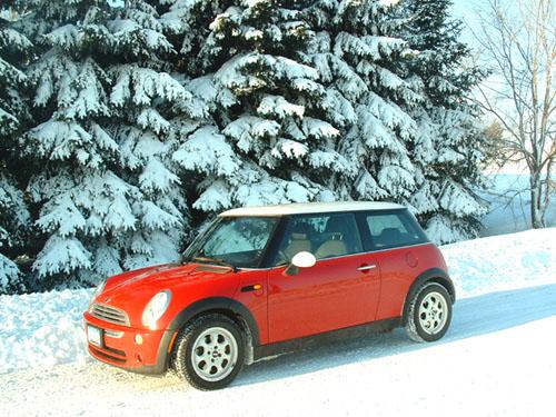

Just some observations based on my experience with my my used 2003 MCS which I've owned for 2.5 weeks. First thing I did was buy a set Michelin Latitude X-Ice tires for the car since I live in Maine. Got them on last week and we got the snow to test them today. In one location I start from a stop sign and climb about a half mile long hill on highly crowned road. About half way up I caught up to a Jeep Wagoneer that was struggling in 4 wheel drive to hold a straight line because of the road crown while I had no trouble at all. I would have passed the Jeep except there was no way to safely see far enough ahead.
I went around and climbed several steep hills without a problem. I'm pretty happy with Mini in the snow.
MINI's love the Snow!
