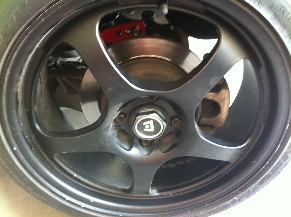

Motegi Traklite 1.0 17x7 Way Too Easy!!!
I have more than enough clearance on these to probably fit on some 16's.

Brake clearance
These look a lot like my Motegi wheels that I got from Tire Rack.one weigh a bunch less than the Challenge wheels that are now my winter tires. Motegi's weigh 16 lbs.
The brakes look like stock Cooper-S brakes, not the Brembos the factory JCW's get.
I dont have an R53. I have an R56 with the 16" JCW brake kit. There are 2 sets that Mini offers. the 16" kit and the 17" kit.
This thread is about the factory-issue Brembo front brakes that come with every 2008+ JCW car. None of the 2008 JCW models come with a smaller set of brakes, although there are some dealer accessory brake kits for non-JCW cars that are labeled as "JCW."
Although the brakes above are red and have JCW logos, they are standard-size R56 brakes.

Dan I was simply stating what the dealer told me.. If mine are just a red pair of brakes with a JCW logo on it, then so be it.. the dealer said they were JCW brakes and that is why i joined on to this thread.
There are in fact 2 sizes of brake kits you can get from JCW. if you dont believe me, look it up on the shipminiusa.com site. there is a 16" kit and a 17" kit.. the dealer said I had a 16" kit..
That's the JCW Brembo front setup.
Unfortunately they look like they are just the regular MCS brakes painted red with the logo attached. I just wish that the dealers and Mini are more forthcoming about what you are really getting for your money.

Whether you choose 18", or 19" make sure you go no wider than 7.5 wide. you also need a 42 offset to fit the JCW brakes.
This will give you the best results with no rubbing.
225 40 18 will fix the speedo error and they fit nicely in the wells.
This is not correct. You can run an 8" wide wheel -- some people have even run wider, although I would not recommend it.
Here's a car running an 18x8" wheel. I had this size on my own 2007 Cooper S.
...you also need a 42 offset to fit the JCW brakes.
Not the case. +42 IS a good offset in terms of tire fitting, but the offset of the wheel does NOT determine whether or not it fits over the brakes.
True!
