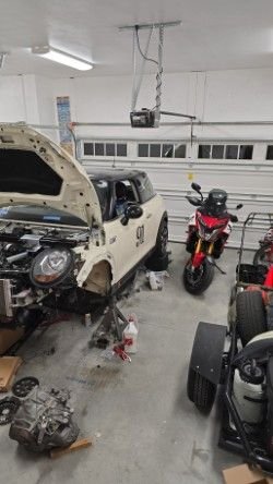

Sorry no update. I have started taking the car apart once again. My 17 year old found something that has his attention more than the 18 year girl he has been chasing. He has hope after all. He purchased a KTM 390 Duke and is focused on this bike. He got his learner permit and is now able to ride with me. So the time drain is that he wants to accumulate the 600 break in miles. All day trip yesterday was almost more than i can complete at this point in life! He is 49 miles short. No time in the garage this weekend. We did ride the bikes yesterday to the autocross i would have been running and watched for awhile. Regardless it is nice to see the young man coming around. I was so over the sneaking out at night.

Forums are pretty dead these days and that is too bad. I will keep posting. I continued the disassembly of my Mini over the weekend. The temps in my garage were over 90 degrees most of the weekend. I could only get so much done. I know many would say I am taking too much apart but having done this before I have found it is more easy to just call it what it is and bite the bullet. Some things are just so difficult if you only disassemble the minimum. For example removing the drive axels is no treat with spindles in place. I am for sure going to replace the serpentine belt this time and I am thinking about flushing the coolant. Here are a couple pictures from Saturday. Looking forward to getting the transmission down to see what happened to the new clutch.

I had time to work on the Mini a bit this weekend. One interesting thing that occurred is when i removed the left rear most bolt for the sub frame it was cover in lubricant. I am tying to think back if I used some penetrating oil some place that would have run down to the location. I will have to dive deeper into how the steering rack works on these cars. It is a possible source for the oil. Not sure.
Pretty close to dropping the transmission to finally see what happened to the recently installed clutch. The sub frame came down to install the new front sway bar and bushings. Since it is down i will check everything out to assure it is all in good shape to reinstall. It was not very difficult to lower.

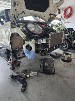

Update. I have the transmission back in the car with a new clutch. Yesterday i got the front subframe prepped and almost ready to back under the car. I do have a question. I don't see information as to the lubrication requirements of the steering rack. The rack did have a slight film of oil/road grime/grease that i cleaned off and thus the question.
this is a picture of the Whiteline bar next to the stock bar.

working on the lower control arm bushings now. Really thinking about ending this thread because am not sure it is really contributing anything to the community.
