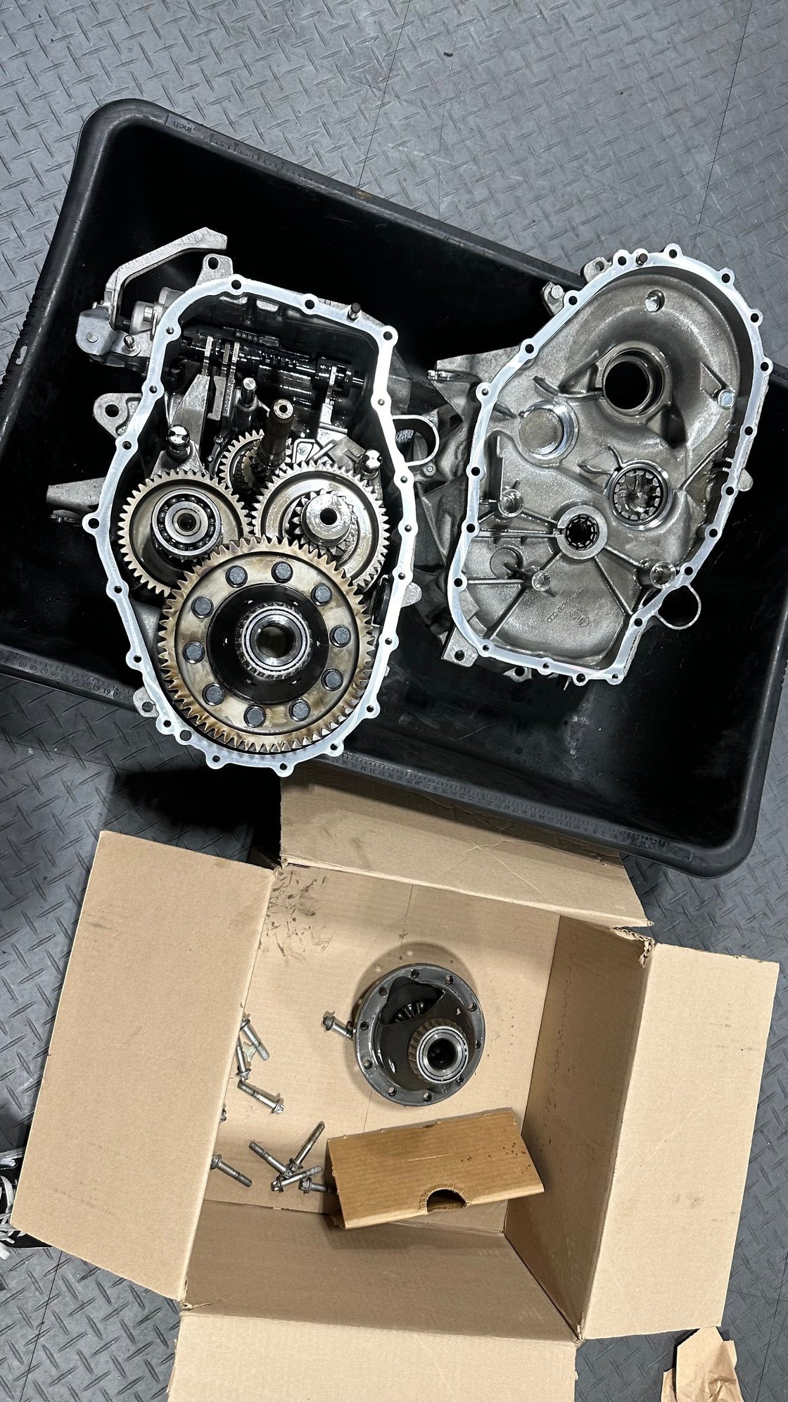

Things like this help

No my friend. But if the STK I am thinking about is the one you are talking about, STK makes auto tranny's only from what I understand. That was a wavetrac install. Custom turbo/manifold, custom software tune (I am a tuner and tune my own vehicles), fuel pump, monster IC and a thousand other little details. I am already working on the next stage with Xona Rotor who is a sponsor of my car
