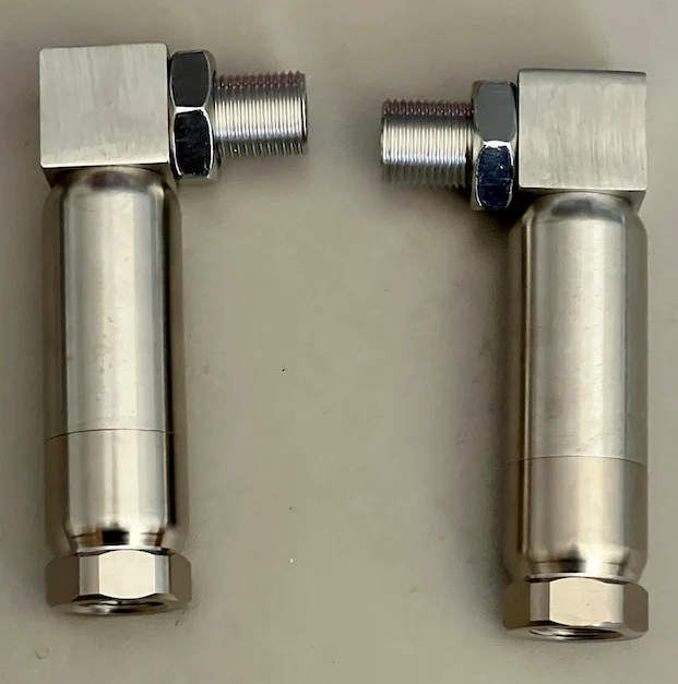

Are you talking about these things?
https://shop.2mfabrication.com/produ...converter-pair
Personally, I wouldn't bother with those, and just get a tune. Get in touch with @Lou@Prototype-R to discuss your options.

that is exactly what I've got & with fresh Oxy. Sensor it seems to be the way to go but if you think talking to Phil @ Prototype-R so be it. I did replace the Primary Oxy. Sensor a while back. months back and my CEL disappeared.

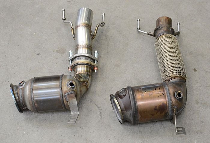

Here is a picture of the OEM downpipe off the car, OEM on the right side:

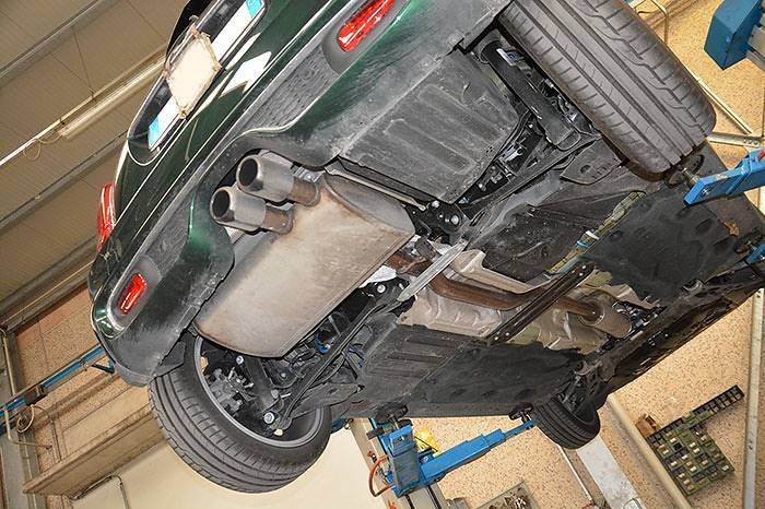

And a picture of the OEM exhaust:
You’ll have to get under the car to see what is there for downpipe. From your description, sounds like the whole exhaust was swapped out. Changing to a straight through muffler will add a little bit of noise, but swapping out the downpipe add a considerable amount of exhaust sound. If the CEL came on, I’d be willing to bet it has to do with the removed cat in the downpipe.
As for tune, probably no tune installed, or the CEL wouldn’t have come on, unless it’s for something other than a missing cat. I’d be curious what your intake looks like…
